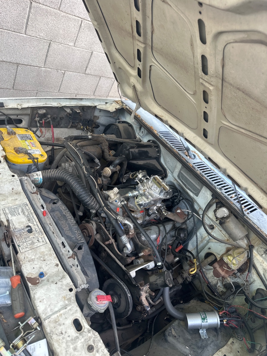

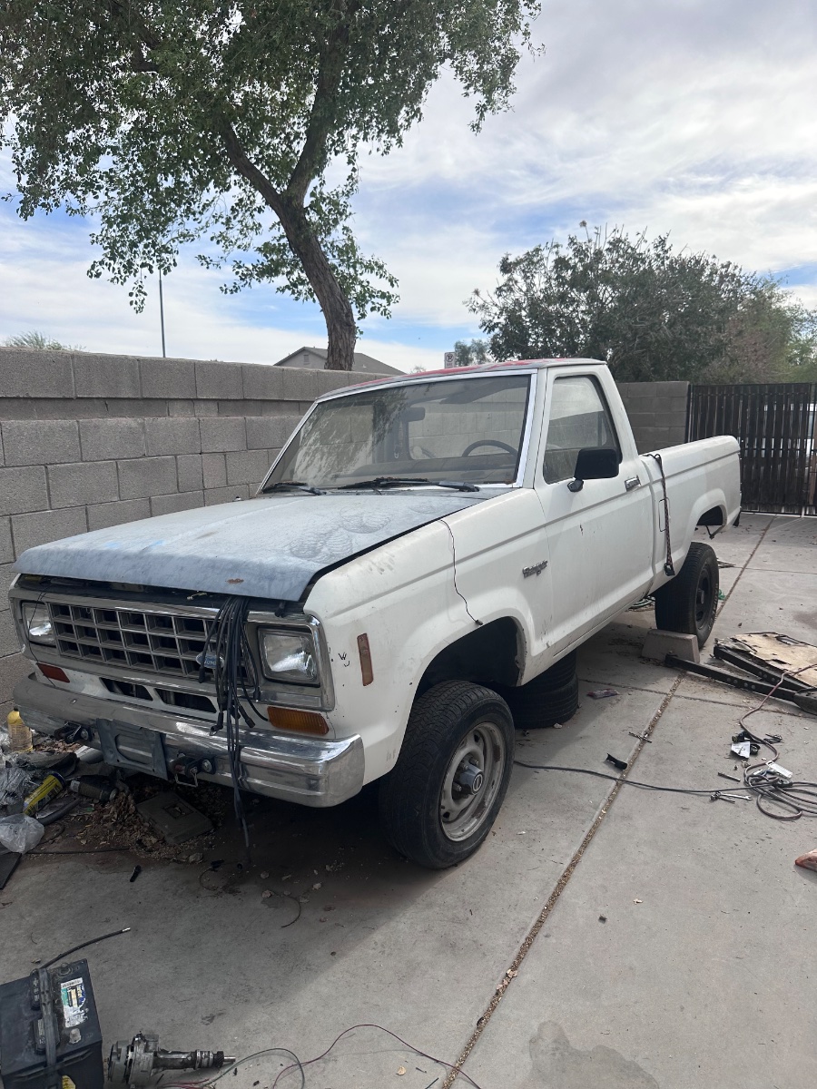

85 Ranger V6 Restoration [Aces EFI time]

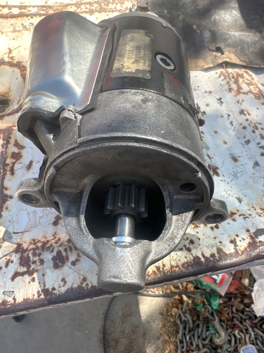

10 tooth drive gear ordered, will be here next week.
So close to getting this thing running, just some minor leaks i need to fix.

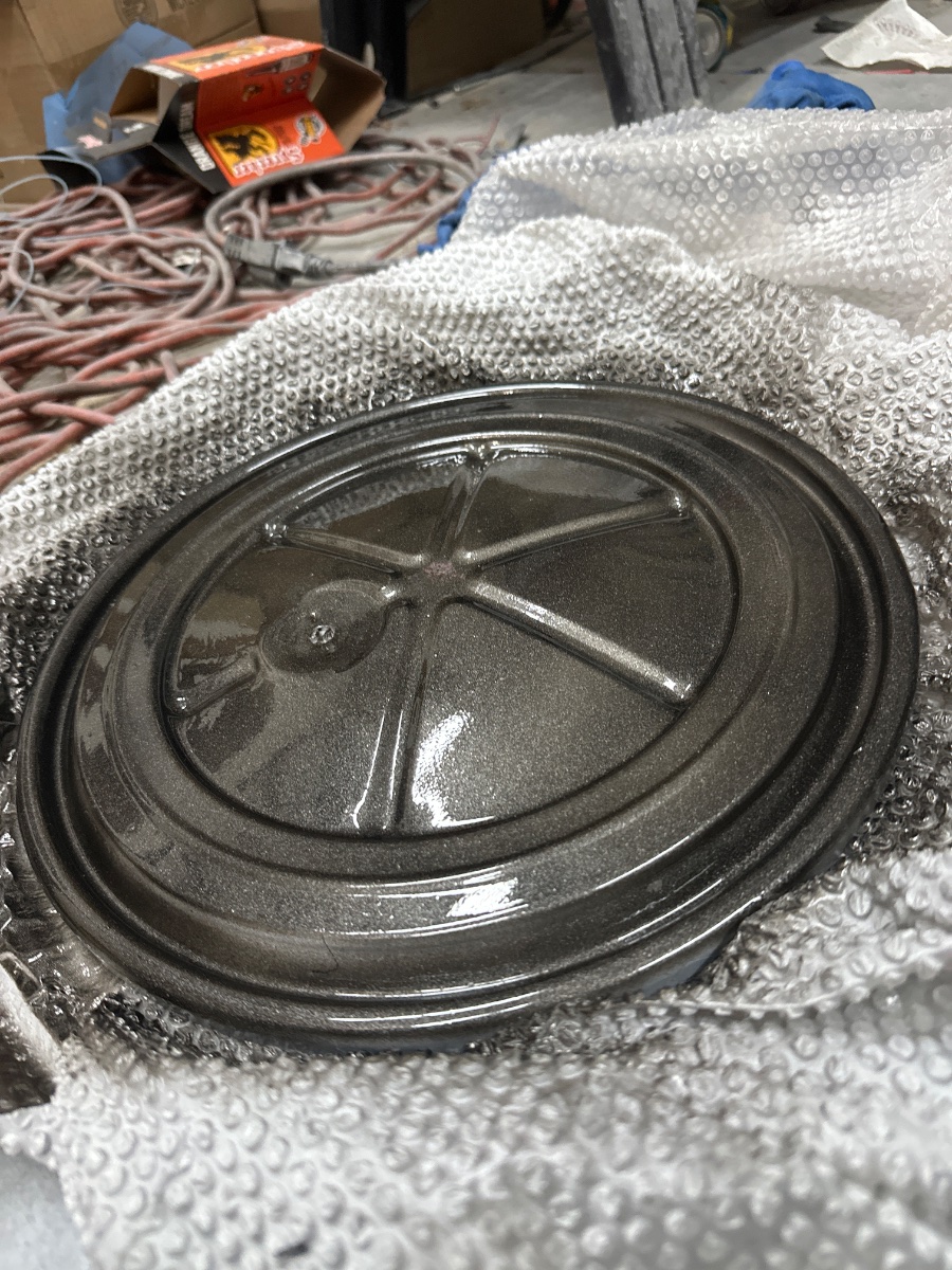

Small stuff im cleaning up until more parts come in! Its coming along together nicely thanks to these forums. I want to be show ready by the end of the year. AC and everything stock functional

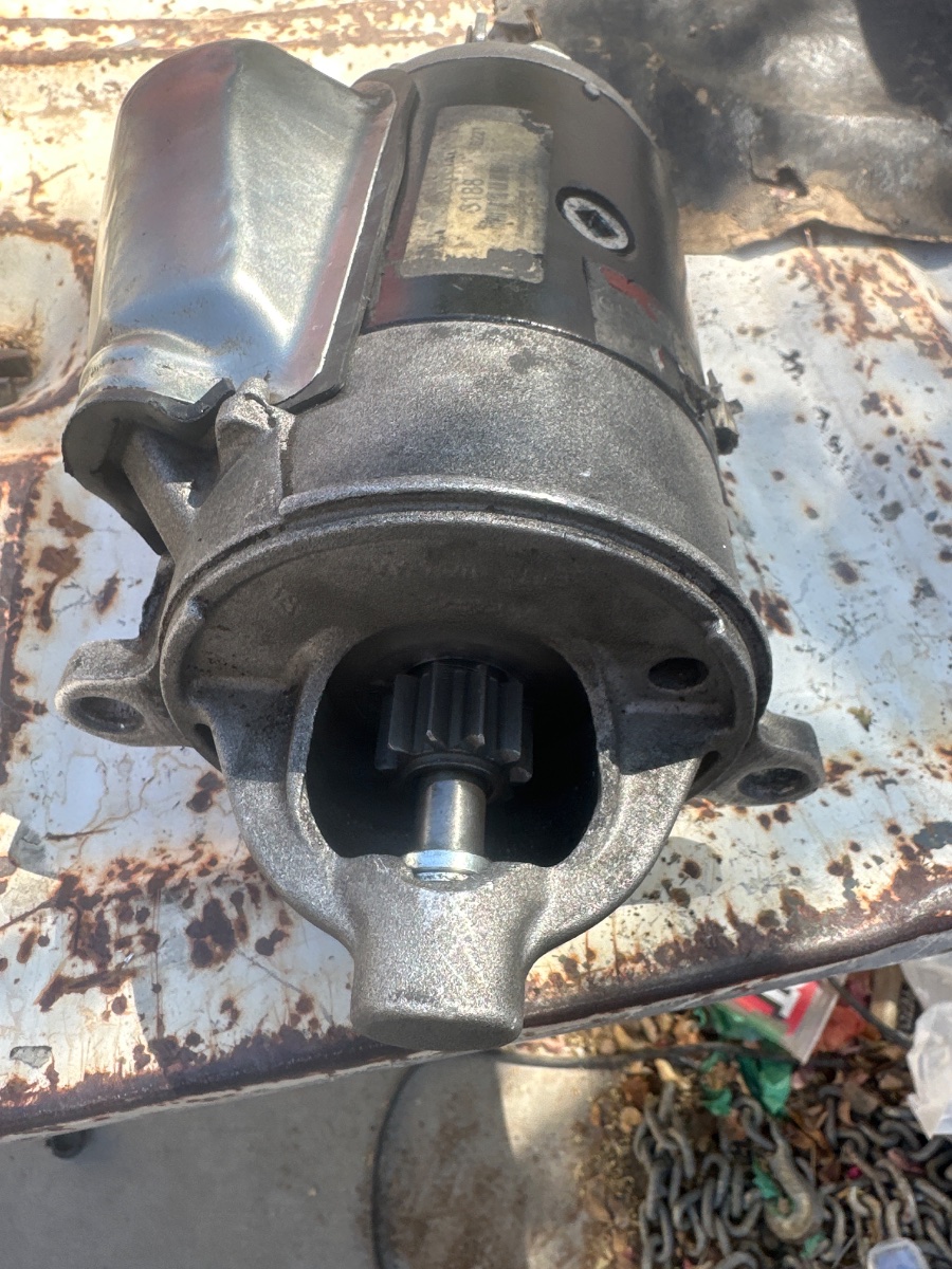

10 TOOTH FORD ESCORT GEAR FTW!!
Easy asf to change out, a baby could do it!
Truck is cranking amazingly now, better then it ever has since Ive owned it. Back to setting timing!

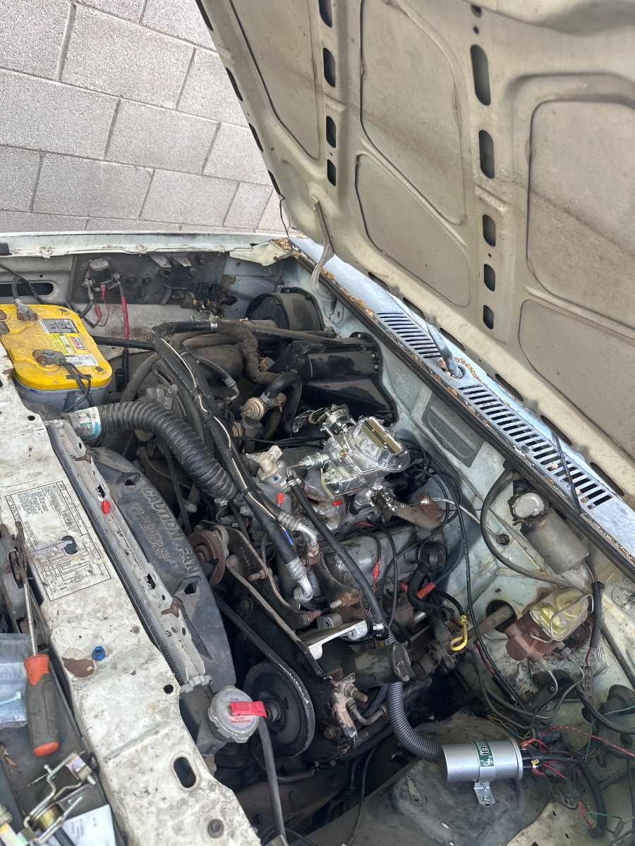

Now my air pump pulley is lock up. If its not one thing its another…
Since i have no ecm and took out all the vaac lines, do i need the smog pump? Shall i bypass it or replace it?
bypassed smog pump. truck is running on its own just fine, but it doesnt seem like timing marks are anywhere near close to desired 12 degree mark. more like 30+ BTDC.
any ideas?
ill probably end up going through the timing again and making sure its set right since i have a decent idea of the procedure now.
still adjusting the carb fast idle, its the screw near the choke cam right? and the curb idle is the screw on the throttle plate/cable?
also LOTS of smoke (oil) from the exhaust, please please someone confirm its just the bad valve stem seals. I hope its not bad piston rings or headgasket issue.

12° would be with vacuum disconnected at distributor, fully warmed up, and at the correct idle. 30+ sounds about where it should be with vacuum hooked up.

ported vaacuum right? i did initial timing with vaacuum disconnected. i need to swap the hose over cause right now its off of manifold vacuum, been seeing mixed answers but ported vacuum should be where i want it at.
