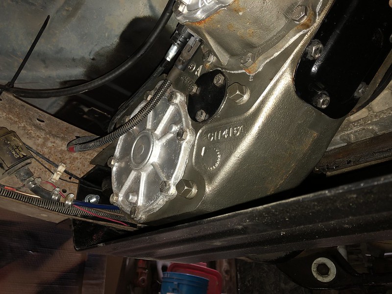

Skidplate fits perfectly, will protect rocks from getting damaged by my t-case... and I finally don't have to trip over it laying in the back of my garage anymore.

Pic of skidplate in better light:

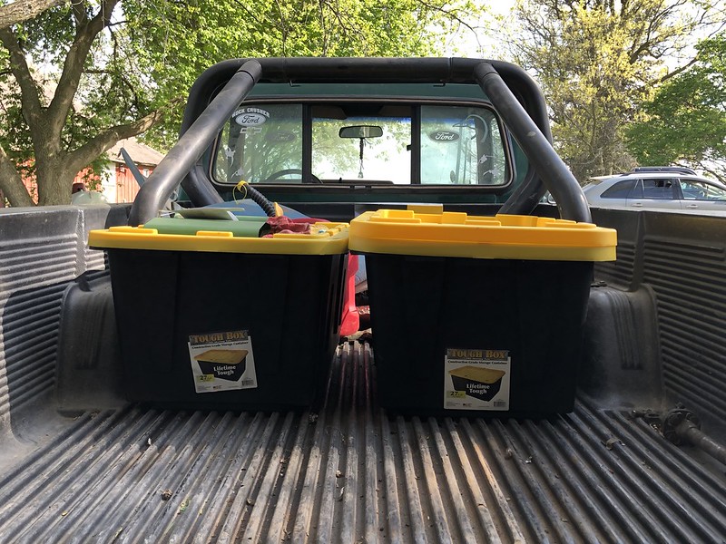

And the totes fit between wheel wells with ease for the trip.

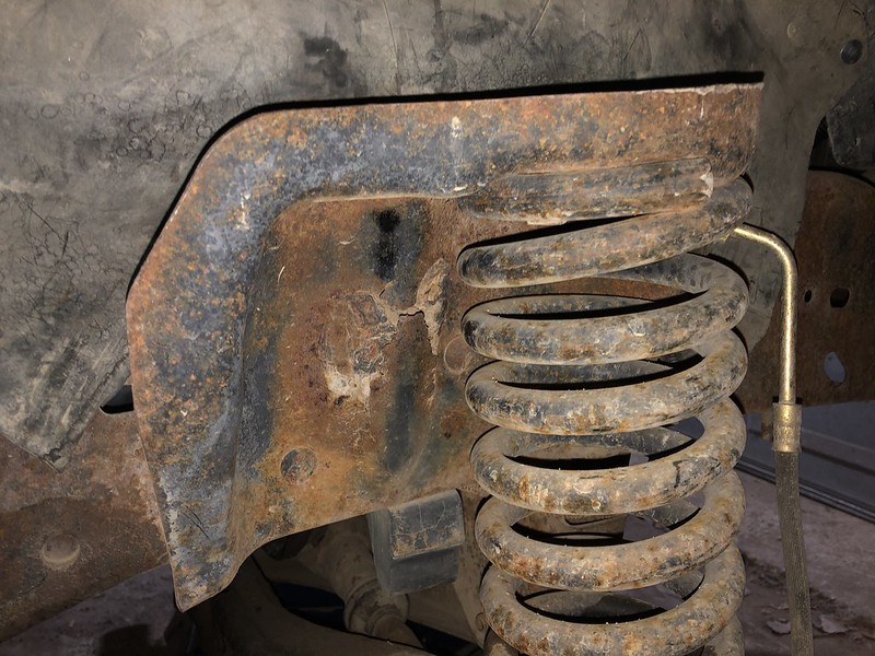

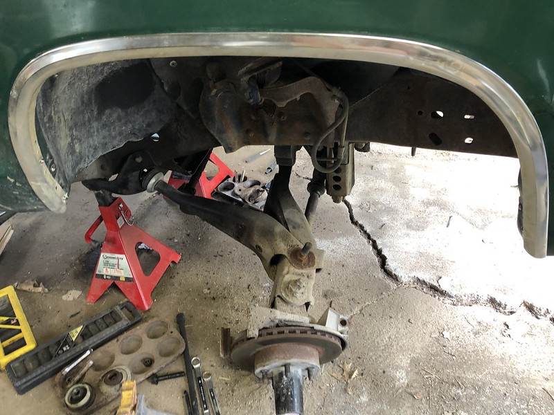

Dang, that ain't good. Frame feels ok behind it so I am cautiously optimistic just a bucket will fix it. DS looks great though.

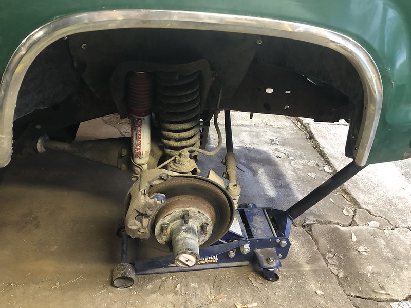

With the weird floor in my garage I HATE having multiple tires off, my initial plan was to swap the D35 beam first so for at least half the process it would have 3 tires on the ground. DS pivot bracket has to come off to change the bucket so that isn't going to work at all.
'85 Ranger Restomod
So off come the tires:
'85 Ranger Restomod
Hey look, I'm a Duramax!
'85 Ranger Restomod

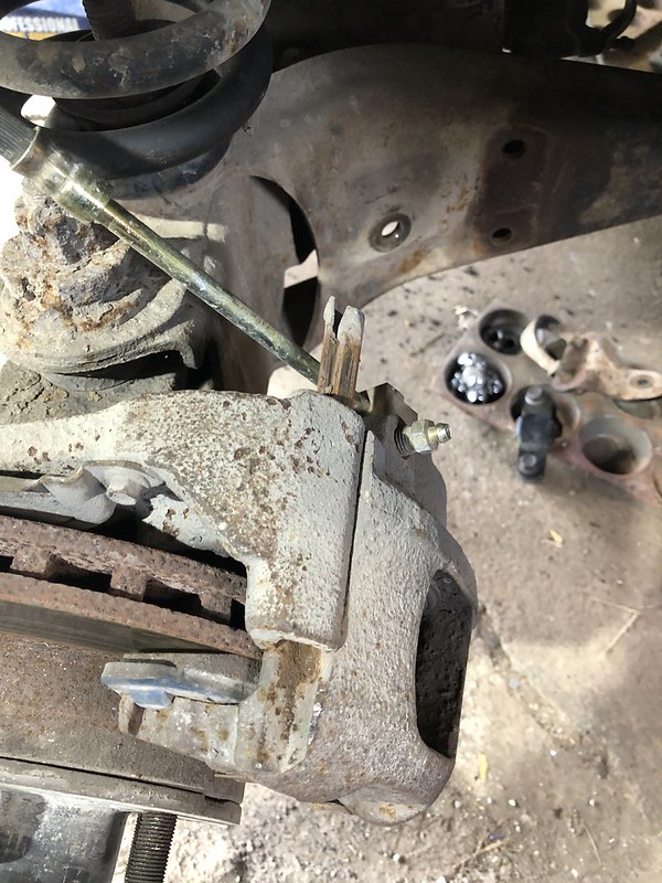

Steering is off, shocks are off, sway bar is loose and just wedged in the radius arms. Just tap out the caliper pins, pivot bracket bolts and radius arm nuts and I think the thing should fall out.
My race truck had the passenger side bucket look good....then I took it off and could punch holes thru the frame with a screwdriver. I ended up plating the outside of the frame with some 1/8" flat stock and reinstalling the bucket.
I couldn't feel any big rust pocks thru the hole in the bucket... so fingers crossed the frame isn't too bad.

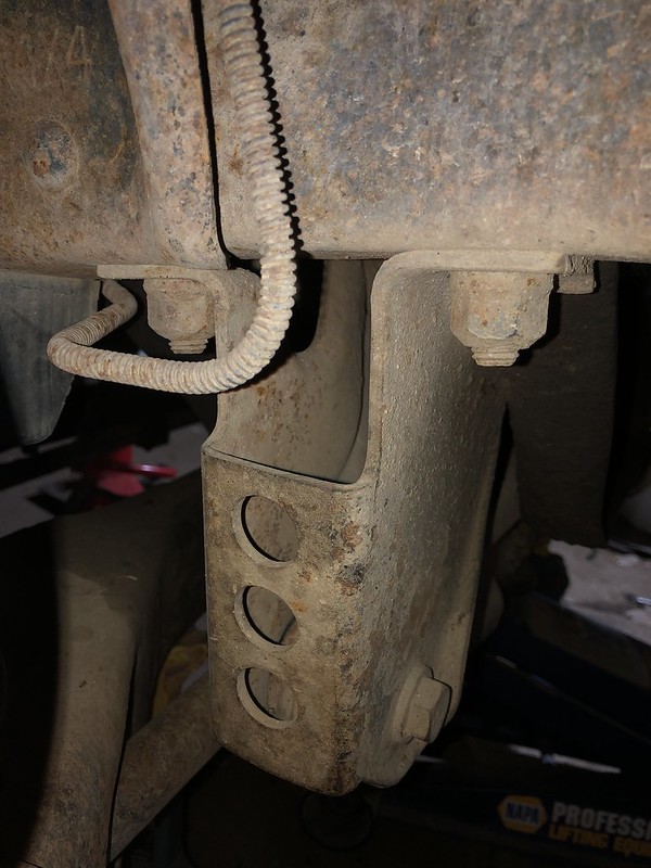

Pivot bracket is off, just have to get the spring mount off and the radius arms off the axles and we can start going back together.
Hey that looks familiar... I just pulled the front axle out of my daily driver yesterday and did new radius arm and pivot bushings. It's not a sloppy mess anymore.
Really not hard to pull. 3.5-4 hours total.
Spring studs I think are going to be a fight though...
My HF earthquake air impact zips them right out, usually. Once in a while I have to use a little heat - even a minute or two with a propane torch is enough. They have a bunch of blue loc-tite on the threads.
