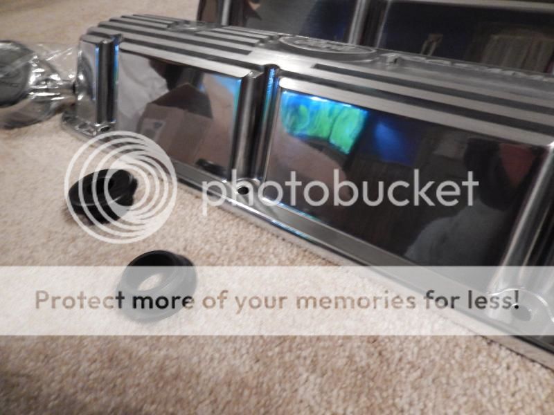

I get them in and get to looking them over:
They have these neat fancy grommets for a baffle type thing. I think it would make adding oil painfully slow.

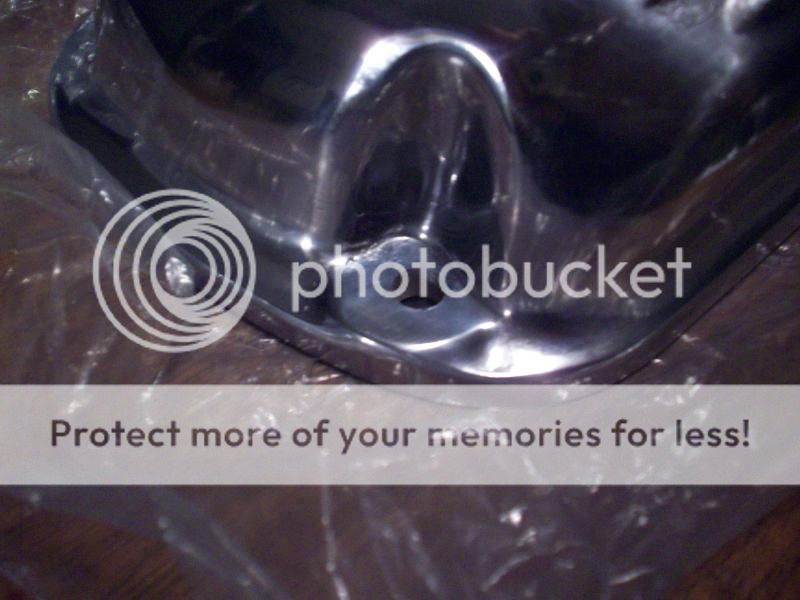

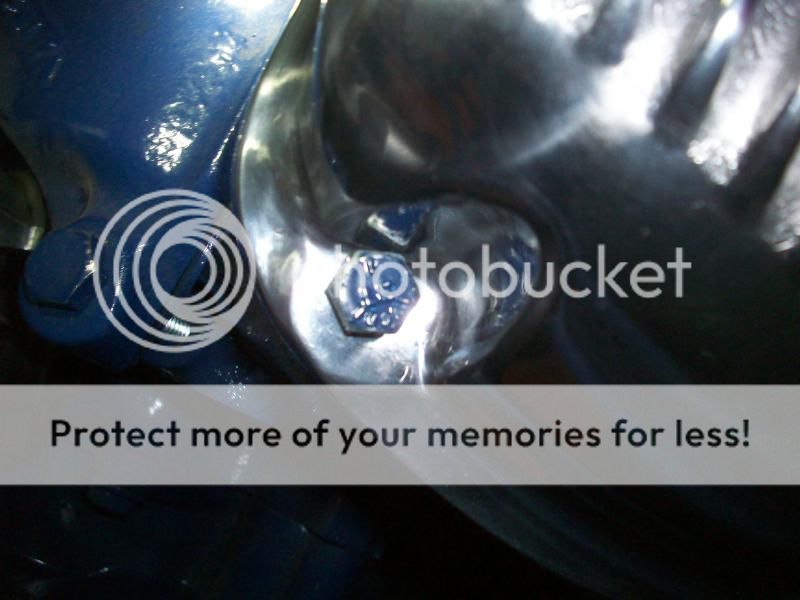

And then I see this, well how is that going to work? Both covers are like this.
So I go over to my living room display 289 to test fit, with a normal hex bolt they drug hard on the side of the dimples. An ARP boltface is about the same as the hex head but has a smaller hex so a socket would have still worked... if the bolt would even start. The pattern was right, all the holes lined up just the whole thing was cast wrong. I could have ground the dimples hoping I had enough meat to play with... combined with the unbaffled design I decided I wanted out.

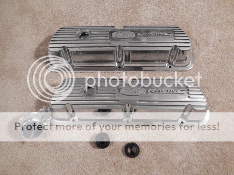

After a bunch of hemming and hawing I decide on a different set.

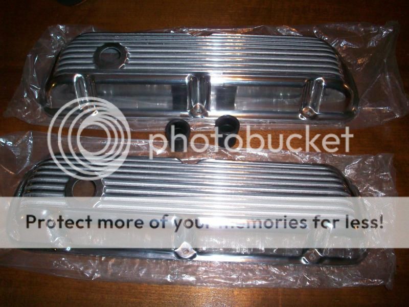

I love the clean almost regal look of Ford Racing's packaging. So simple but somehow really classy.
Made in USA to boot. :yahoo:

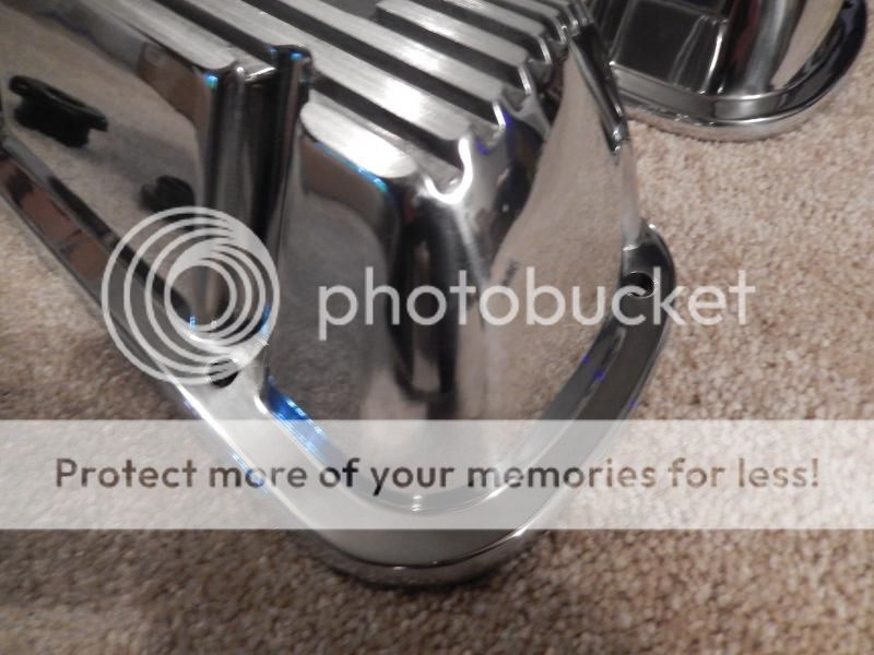

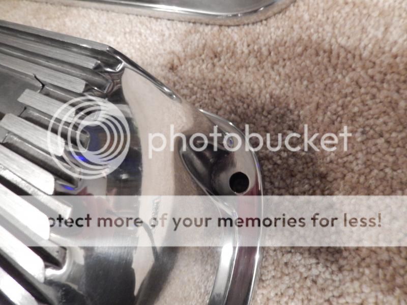

The sides have a nice mirror polish.
They actually got the dimples to line up with the holes, even with room for a bolt head. :shok:

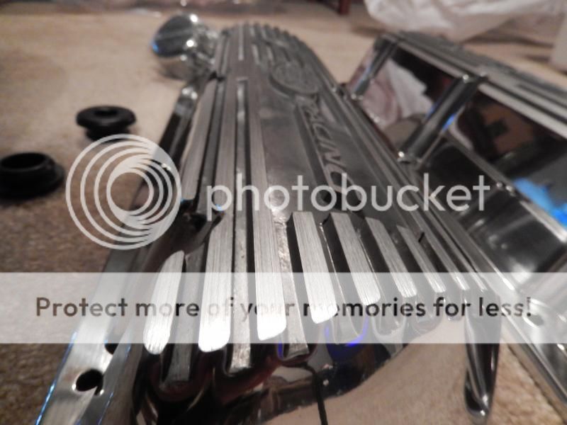

The fins are rather roughly machined, where they machined around the lettering isn't really really pretty with a few extra burrs but nothing really glaringly bad.

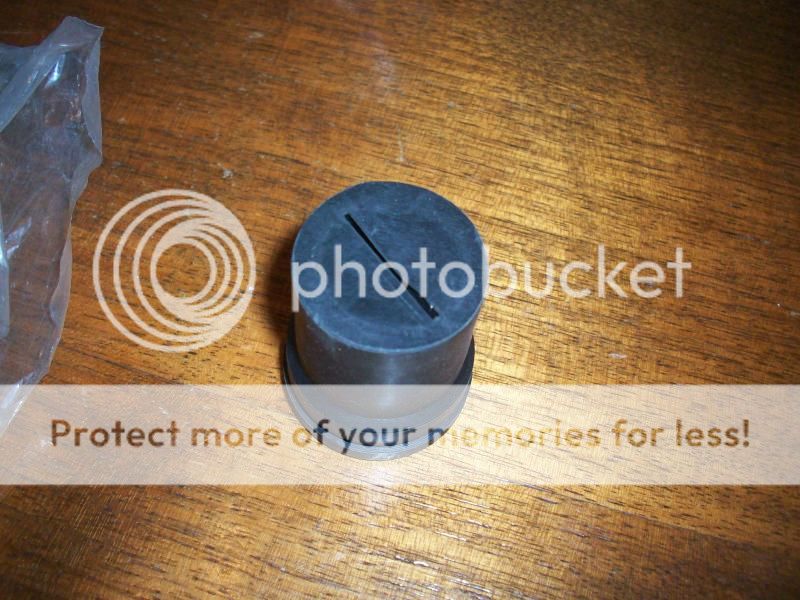

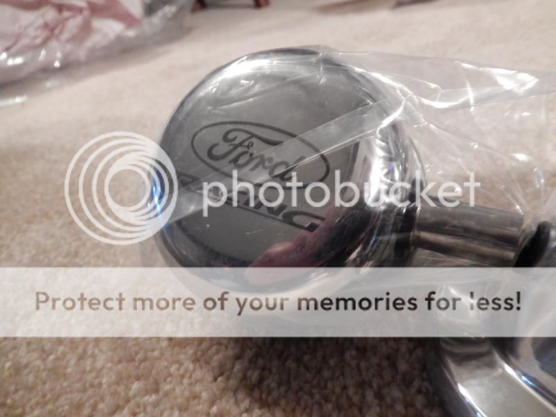

The included oil cap has the Ford Racing logo printed on it, I wish it was rotated 90* so it would be level with the world installed. I hope that the nipple is the same size as my Edebrock nipple too.

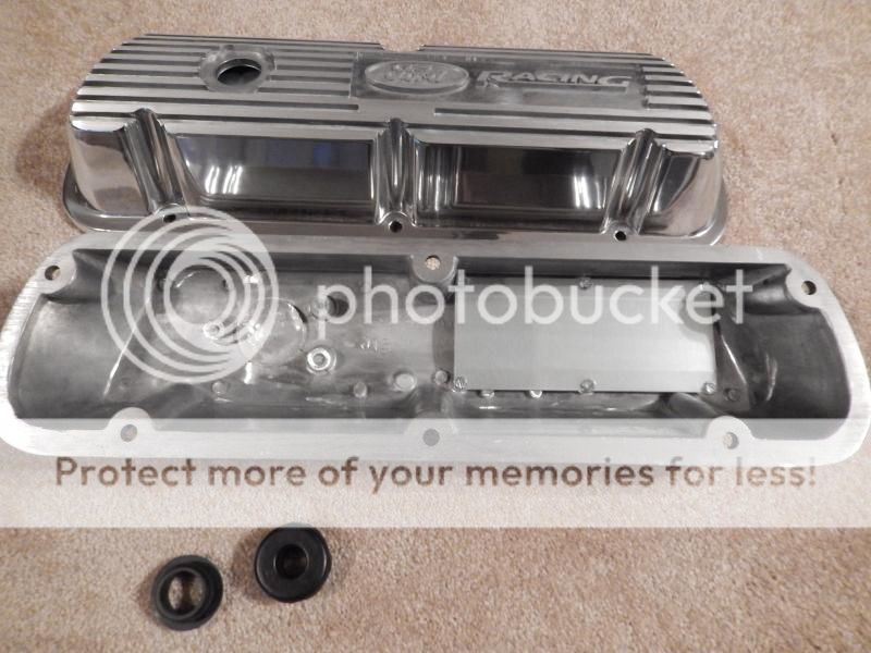

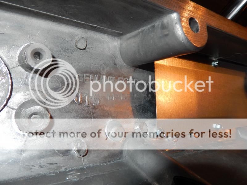

Nice big baffle, kinda roughly cast on the inside but nobody will see it anyway. Kind of odd they have a second boss for a PCV/oil fill hole on the other end of the valve cover.
I see a "Made in C" cast into the upper side, I get a flashlight and it is "Made in CA USA". Them dirty rascals. :D
