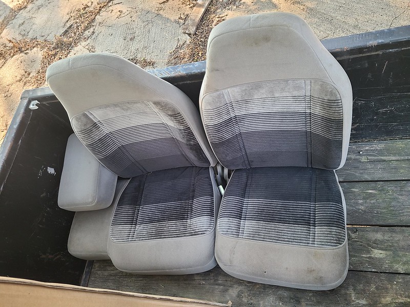

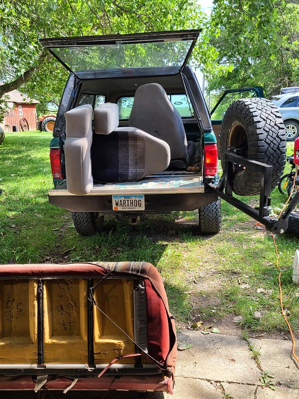

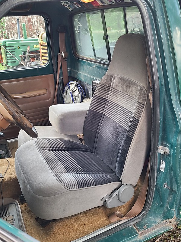

My FIL just inherited a really nice 66k mile '91 Ranger from his BIL (who inherited it from his father who bought it new)
He decided he wanted to put bucket seats in it so he offered me the split bench as he had no plans for it, so I says sure. The bench seat kinda sucks for long distance driving.
Surgery time:
I have tried Explorer highbacks and Eddie Bauer BII buckets both of which failed due to hitting the back of the cab... so I stuck the DS in with just the two outside bolts to get a feel for it. It was deemed good enough to proceed.

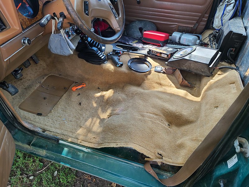

And because I had replaced the floorpan I had to pull the sill plate and rear speaker on the DS so I could drill a new hole in the floor for the front inside mount.

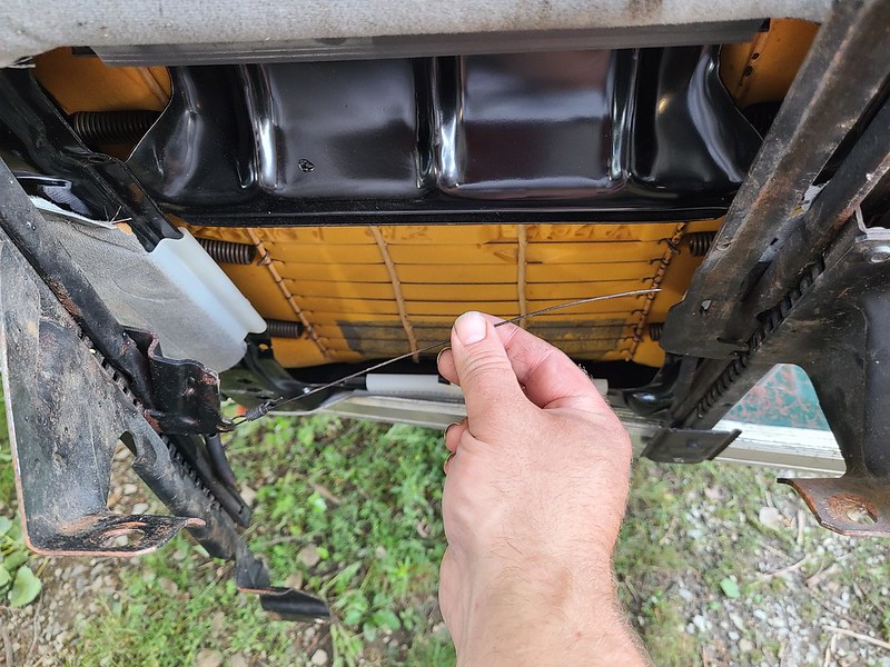

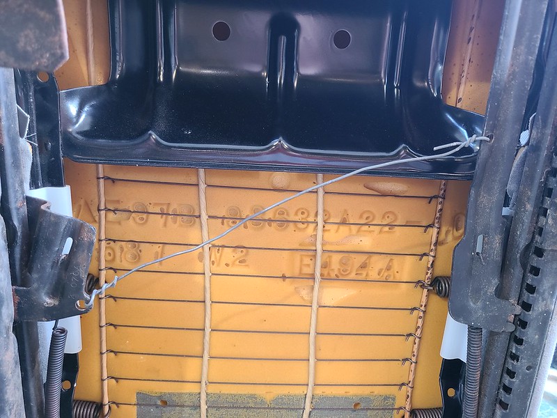

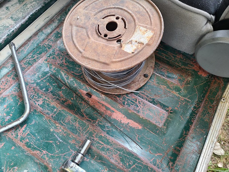

Mounting tracks on for the PS and of course this little cheesy wire breaks that works the latch on the tracks. Great, it is going to be a PITA to mount that in without being able to slide the seat around.
But wait, from the shadows the savior of the farm appears...
Not like we are trying to hold hogs but that should work.
Done!
Man them XLT guys don't know how good they have it, it is like driving around while sitting on a couch. Armrest is nice... I am a happy camper. Also it is easier on the rear window if a guy can whack his head against the headrest rather than the back window in an accident.
I need to figure out what to do about the color, new covers are $100+. IIRC the upholstery guy said figure $150/seat to recover a bucket... we have a car club meeting tomorrow night and I am going to bug him about it.
And of course my neat cupholder which worked so perfect pinched between the bench seat and the floor is flopping in the wind now because the center of the split bench is a inch or better off the floor.

BTW "boots brown" is a pretty good match for my tan, it is what I used for my cupholder.
My wife's grandfather was a smoker and they do have a few burn holes in them so they are not super perfect. Even if I wanted gray I would probably want to recover them eventually because of that.
I have the same gray color in my '90 Bronco II, but straight buckets and not 60/40. In a lot cases the seats of this vintage wear very well (as the case in my B2).
I think you'd be making a good investment, in having those recovered to match your interior.

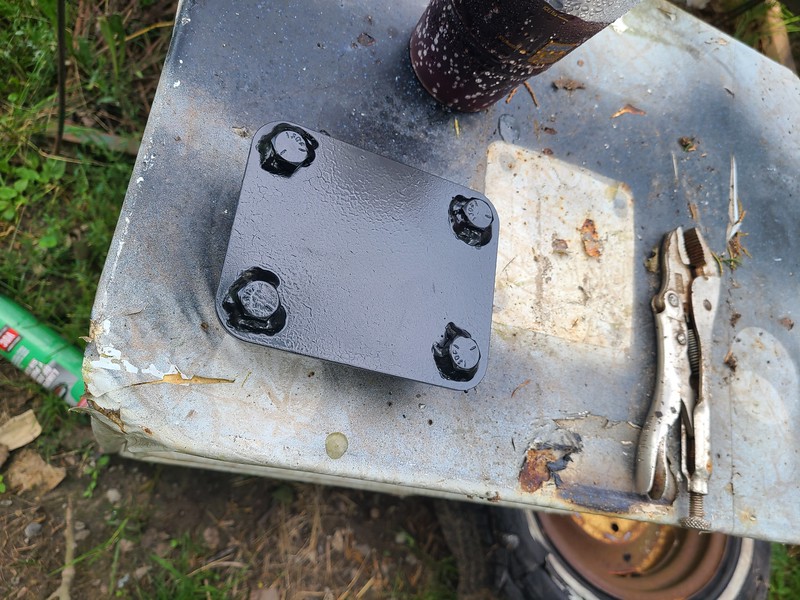

Welded four bolts on one of the backing plates for my slider:

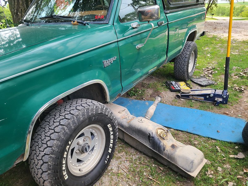

Dropped the fuel tank, drilled four holes and installed the plate:

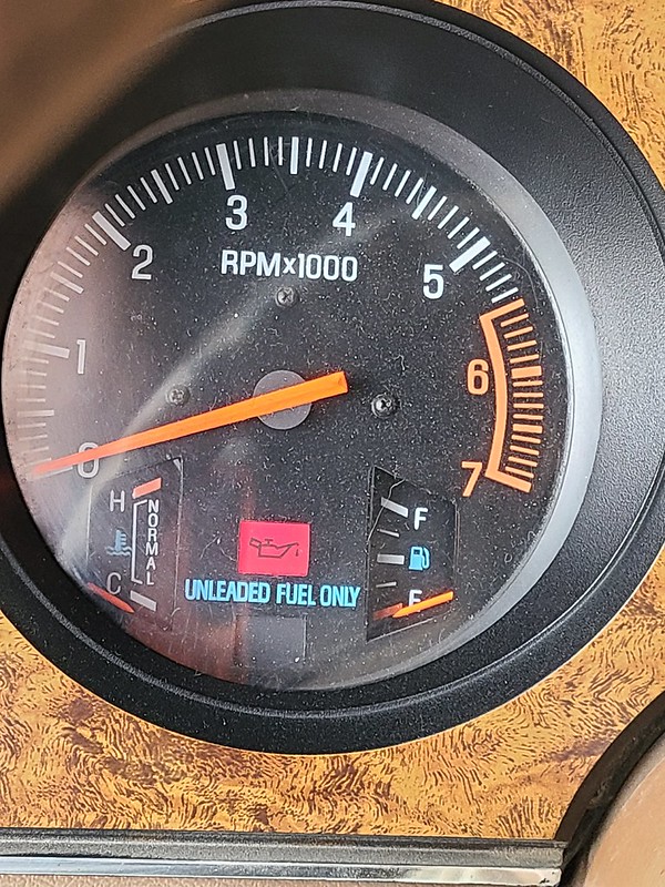

Tweaked on the fuel sender arm so it will actually go a little below the red line before I am out of gas (it would run out not even fully lined up with the red line)
And threw the fuel tank back in it which is much more difficult with the rear driveshaft installed.
