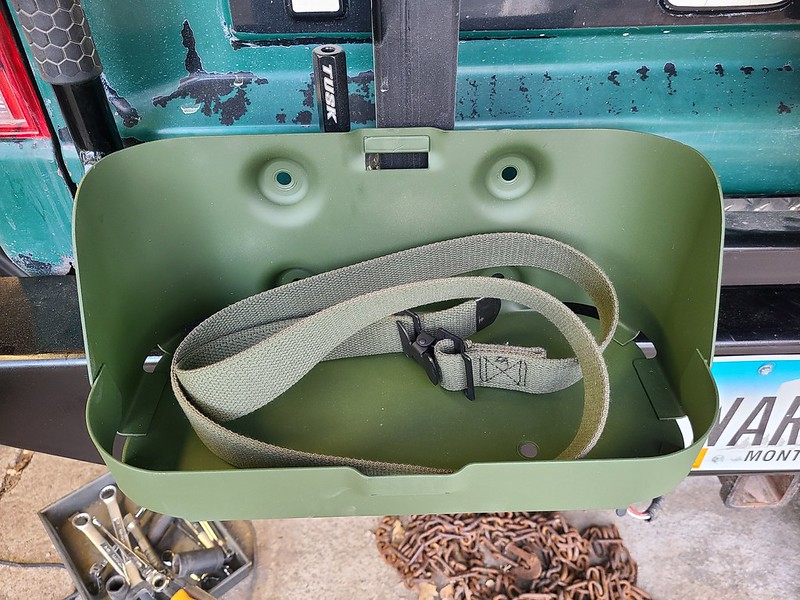

Kinda stupid but my 1943 USMC jerry can from my grandpa will look neat on the back.
'85 Ranger Restomod
Not sure if I will "use" it, I do intend on cleaning the varnish out of the inside, lining it, cleaning the old paint and rust off the outside and repainting it. More or less restoring it.

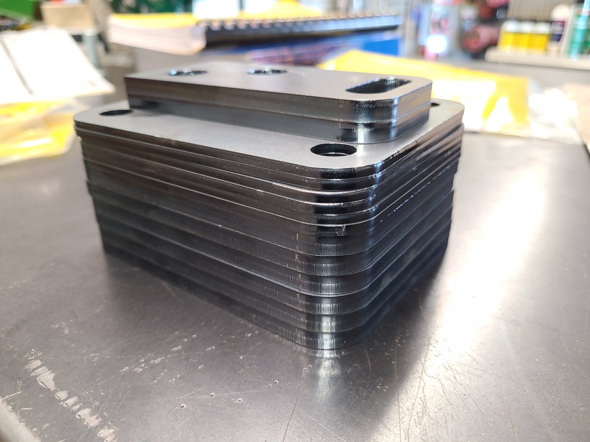

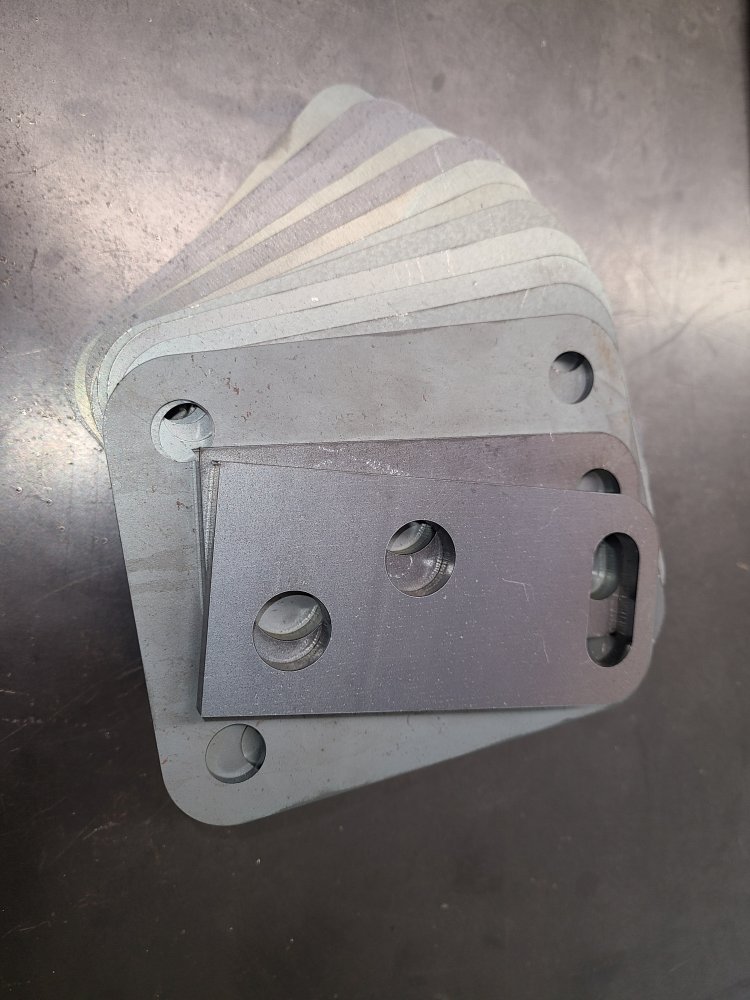

Plates for mounting the sliders and my rear camper tie downs came back from the local fab shop today.

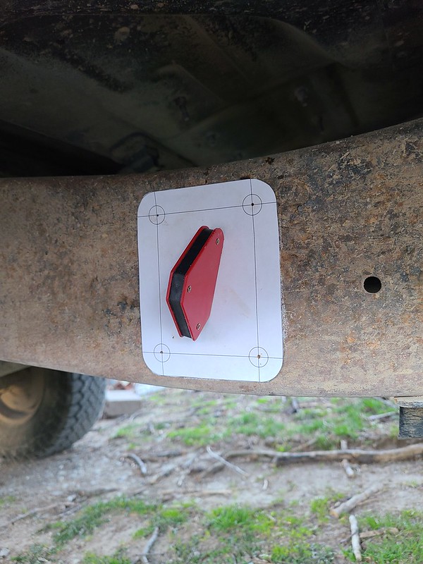

Marked up where the braces are going to land:
'85 Ranger Restomod
My scientific method for center punching holes...

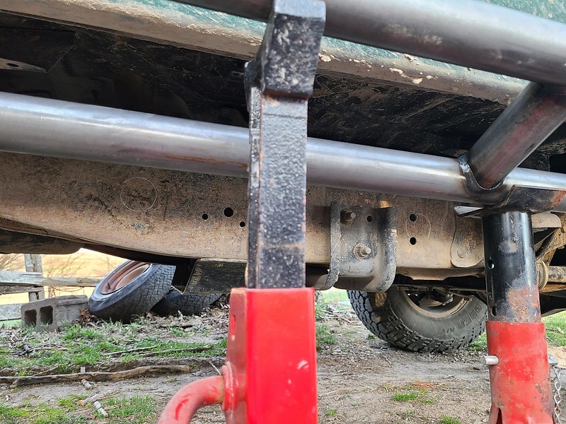

Everything kind of mocked up:
'85 Ranger Restomod
Kind of hit a snag. I forgot during my engine swap days that a Ranger frame has the straightness of a wet noodle. I have the distance set about right with the front one, as you can see with two in place the slider is kicked way out at the back compared to the rocker panel... so I need to fiddle with it more to get it square.

Damn man that all looks great! I bet those laser cut plates are nice to work with; one of my biggest annoyances with fab work is cutting out the brackets and drilling 100 holes. Welds on the tubing look perfect as well.
I dig the jerry can
Yeah, measuring and drilling holes in 12 plates would have gotten old pretty quick.

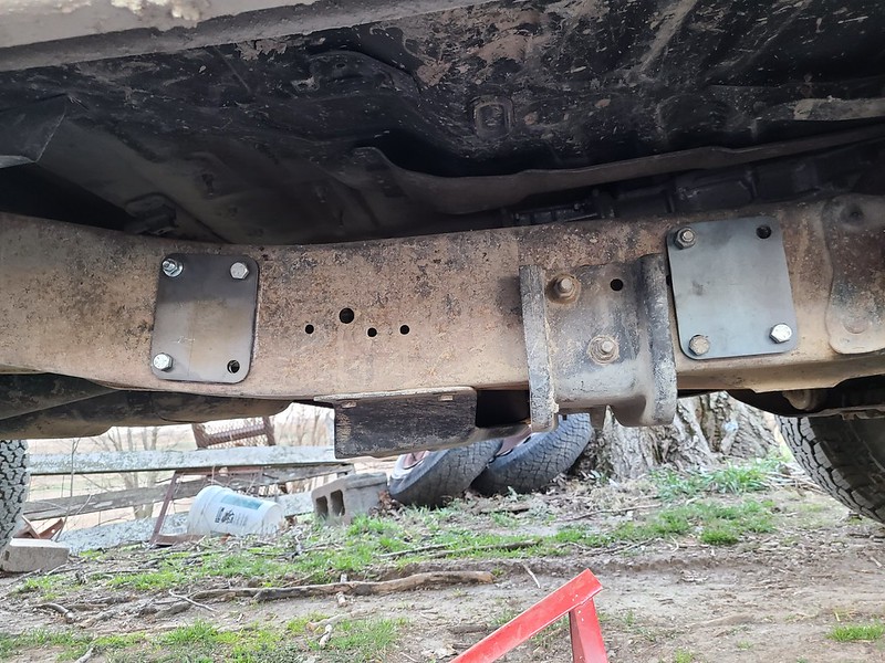

I probably wouldn't have had to do backing plates but the idea hit me for the mount that is going to get blocked by the fuel tank. If I just welded the bolts to a plate I wouldn't have to drop the tank to take the slider off. Then it hit me it would help support the frame if I had plates on all of them. I am only welding the bolts for the one mount though.
Welds do look really nice on the tubes, they came that way though.
