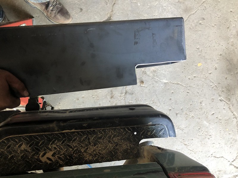

Compared bumpers:
'85 Ranger Restomod

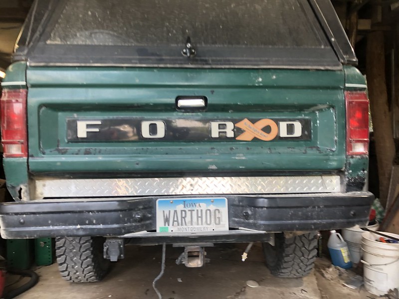

Before:
'85 Ranger Restomod

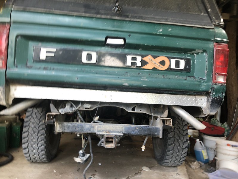

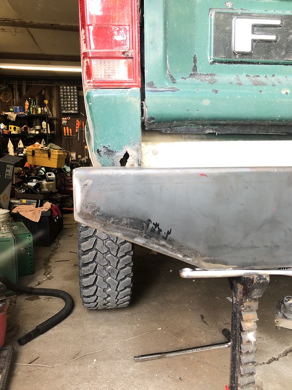

Got the old bumper off:
'85 Ranger Restomod

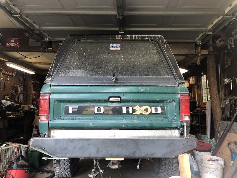

New bumper is sitting roughly in place, it is about an inch low:
'85 Ranger Restomod
It doesn't stick out as much as it looks like it does:
'85 Ranger Restomod

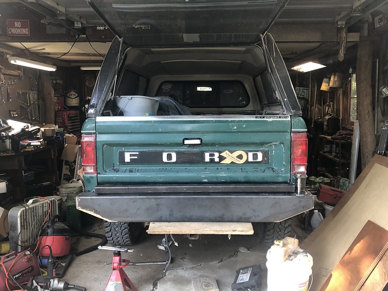

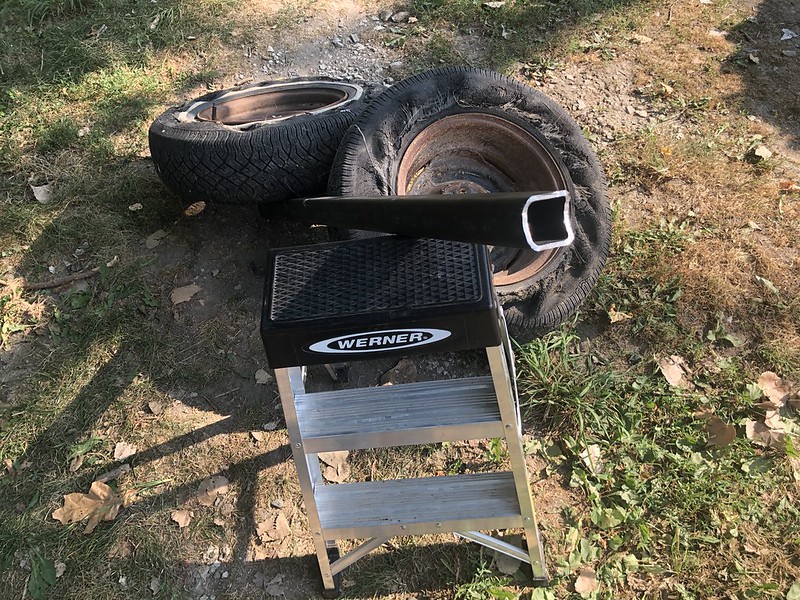

I found a hunk of 100+ year old 1" dimensional lumber to shim it up to where it is supposed to be, the tube I have for the swingout is sitting on nuts to simulate its placement:
'85 Ranger Restomod

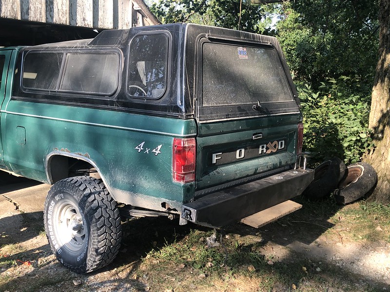

Backed outside, looks pretty good in the daylight.
'85 Ranger Restomod

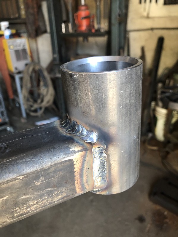

Hinge is welded on the main arm of the gate:

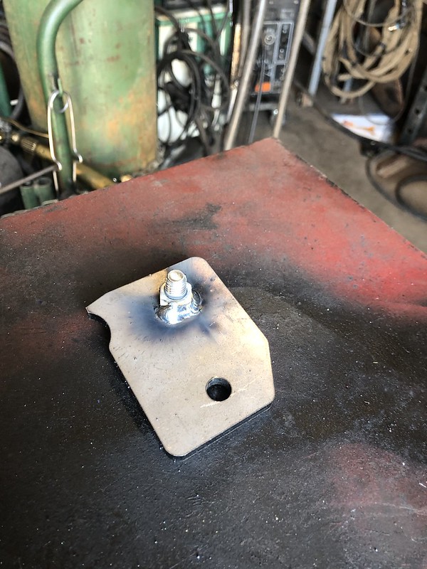

And the nut that is going to end up in the tube is welded to the lock plate:

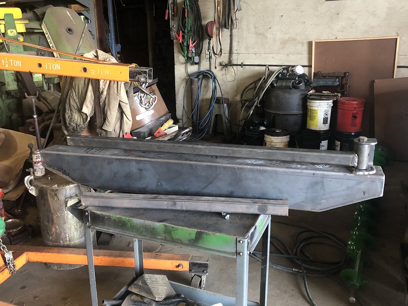

Threw what I have so far for the swingout on the bumper... that hinge is like butter.
'85 Ranger Restomod
Have you done any load testing on it yet to see how much it will sag? I'm just curious since I'm seen other swing arms with more buttressing and a taller hinge post so the carrier has an upper stiffening bar that forms a triangle.
I can bend the tube down to touch the bumper by hand fairly easy. It is 3/16 tube so it isn't super light duty stuff. I just stuck it together at break and played with it a little. It is hard to get too rowdy or the whole thing wants to start flopping off the table.
I don't know if the flex is from the tube or the top flange of the bumper. When I get the actual bumper mounting brackets in I do plan on strengthening the top flange of the bumper by running a support just inboard of the hinge down inside the shell.
The actual design for what goes on top the tube is kind of in flux until I get the bumper on the truck and see how the spare tire fits.
The basic layout of mine was inspired by this one:
But I want the jerry can to sit flat against the gate. Just for carrying water.
Not sure what you mean by a taller hinge post. Most just run a single shear trailer axle stub with kind of mixed results.
