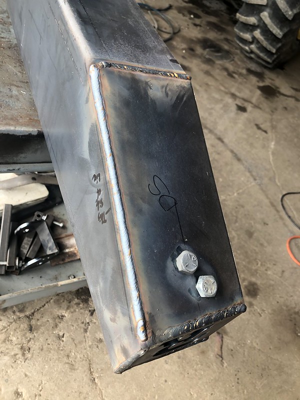

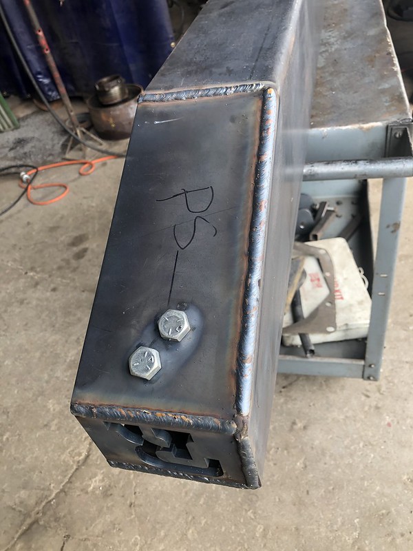

Bottom plates are welded on:
'85 Ranger Restomod
'85 Ranger Restomod
What are those bolts for?
LMAO.... I asked the same thing!

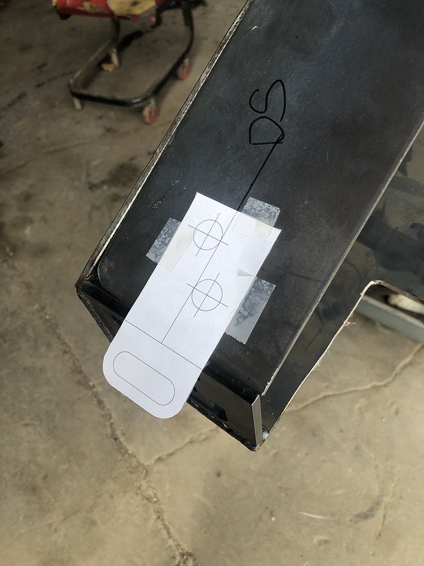

Well you see a while back some guy talked me into a camper... and I am not overly fond of the clamp in bed mounts. So with the help of my high dollar laser rapid-prototype machine here is what I am making to bolt on there.
'85 Ranger Restomod
And they can be flipped around so they are not sticking out when not needed.

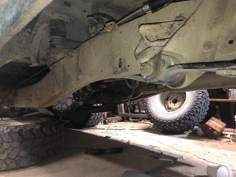

Also later tonight I got the sway bar in and tight for good (in theory)
'85 Ranger Restomod
Parking brake cable mount was remounted higher since I needed the hole it was in for the sway bar:
'85 Ranger Restomod
It now clears the defunct stock mount with ease and misses the cab mount by a good quarter of an inch:

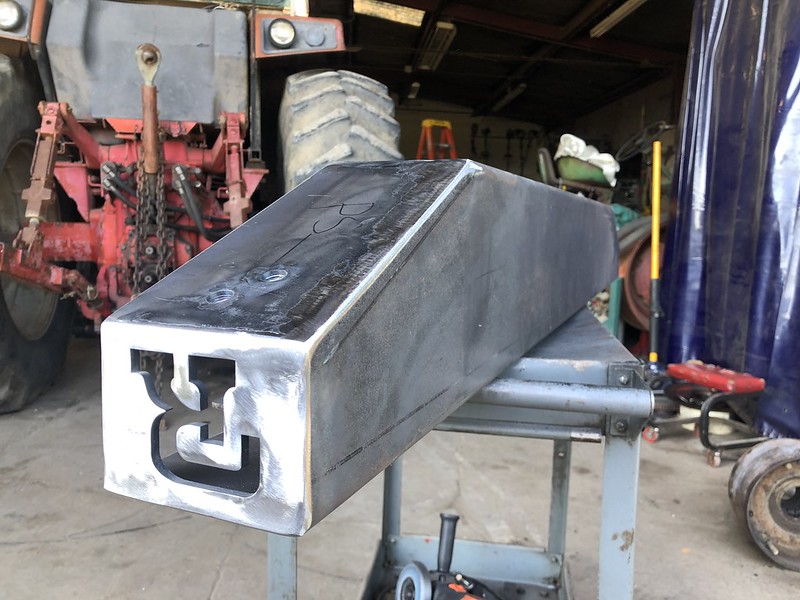

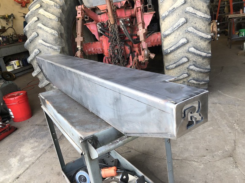

No no, and I am glad it caught me when it did so it was easy to tweak the bumper when it was still apart.
Between the external tie downs that will be good for other things and the sway bar which will be nice next month on the road the truck is better for the things the camper has needed.
And after 18 years I finally finished my pickup box trailer...
Bumper is pretty much blended:
'85 Ranger Restomod
The pretty much complete shell:

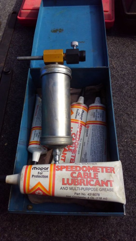

Never found anything better.

I go in any parts store and ask for speedometer cable grease and they look at me like I asked for a hyperdrive for my romulan warbird. Nobody has a frickin clue.
I see some use lithium grease which I tried first and it worked at low temps. High temps (like above 70*) it thinned out. Everybody else said use graphite so I tried that and it was worse.
I see Dorman also makes a graphite oil for them.
Whatever, I am going to start over with a new cable, I had to modify this one to fit and it is a PITA to install. If we go the stupid thing can just bounce all the way to Indiana, I have GPS.

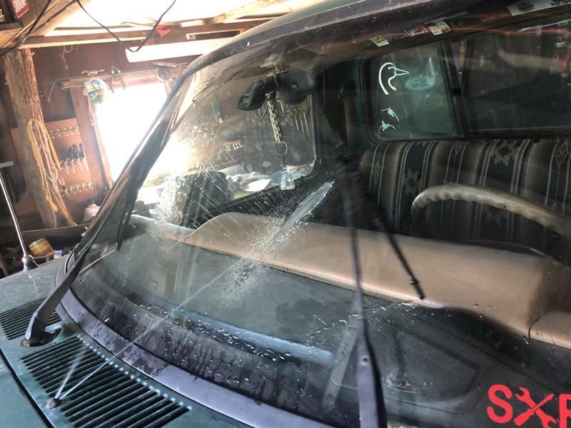

Went to clean the grounds for the headlights. I pulled what I thought the drivers side off and pulled the switch to make sure I got the right one... and all the lights work. Ok, whatever. I hook it back up and pull the one off the passenger side... and they all still work. Consault my EVTM and note there is a shunt so there is actually a backup ground for both headlights, the two grounds I had pulled were connected. So I pulled cleaned both.
Also cleaned my windshield squirter, so that works now too.
