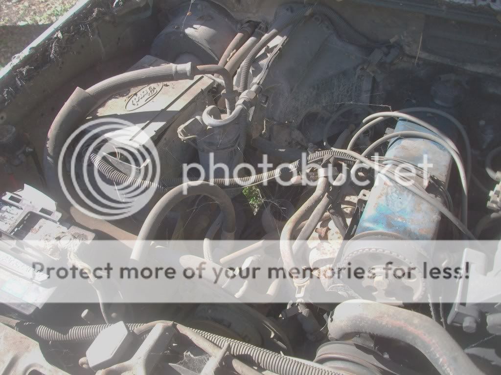

I replied to your other post in my thread. If it's running rough and knocking it could be a timing issue. I think you need to start with that. I haven't seen your other pictures yet, but can you take a pic of your engine bay? Do you have any emissions equipment on there like an air pump? A lot of times those peices/hoses (if originals from 85) can become gunked up and suffocate the engine. I thought the emissions equipment started in 86, but I could be wrong.

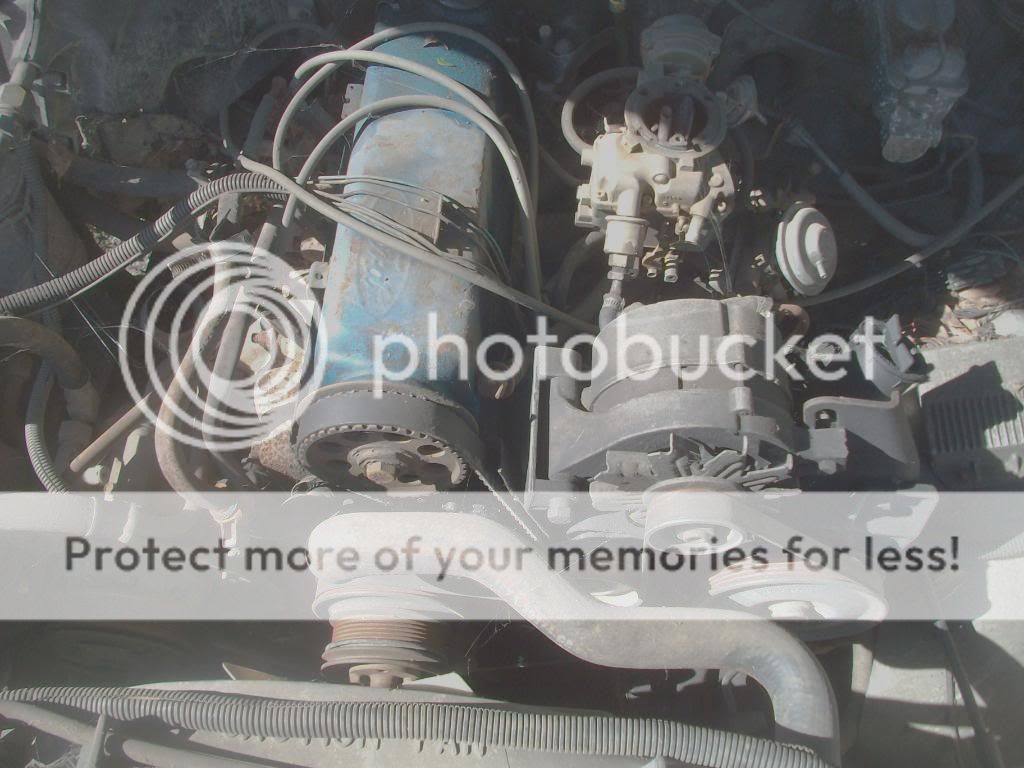

Maybe timing??? Lets try this. Here is the engin
Set timing. Timing should be perfect now. It still sounds pretty rough. Not sure what I could do. I keep wanting to buy a carb and install it. I feel like I am itching to do it but my neighbor (a frickin lube tech) said it wasnt necessary/ Distributor is set right.
I have new distributor cap, rotor button, spark plugs, wires, starter solenoid, alternator, belts, oil, and cleaned the engine a lil.
I dunno what else I could do to make it run better and not eat so much gas. I tried adjusting the carb. When its lean, it runs pretty rough, and when I make it run with more gas, it sounds better, but still rough. Engine shakes pretty hard. No knocking though????
Any suggestions
From the one pic i can see cut lines going into the carb. Plug them up and see what that does, as vacuume leaks can cause an engine to run rough. If that doesn't work, buy a spray can of starter fluid, start the engine and try spraying that around the carb gasket. if the engine responds (you should also see bubbling around the areas you sprayed) then replace those gaskets/hoses. Hope that helps

No emissions gear I see.
Check for vacuum leaks around the base of the carb. I never had success with spraying any kind of fluid around the engine bay to check for leaks.. just went ahead and replaced the gaskets. Checking for a vacuum leak might be your next bet.

Two things I noticed...the pump on the left side is either an A/C compressor (about 50 lbs of dead weight unless it works properly) or the air pump (a mere 20 lbs of dead weight that can be removed unless specified by your State) for emissions: and the EGR vac line is off...that line may be plugged at the other end, but make sure there are no open vac lines...
As for the loud 'clank'...it could be caused by whatever it is on the left side of the engine...take the belt off from that pulley and while you're there inspect the bracket to see if it's broken...
Mine had snapped and the air pump was flopping around like a fish out of water causing all kinds of scary fish flopping noises...metal fish flopping...
