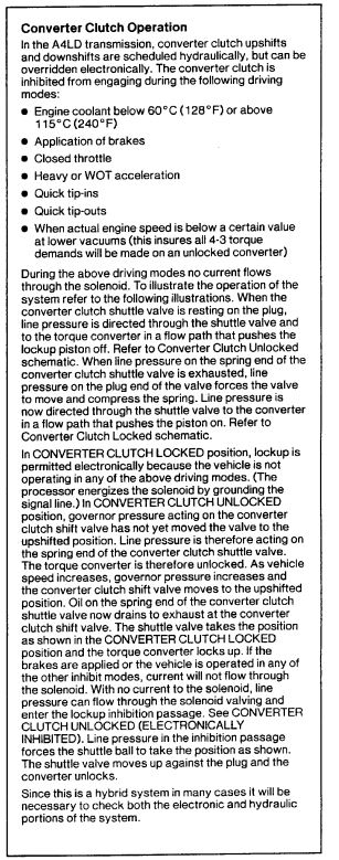

I did some more reading on the manual and it appears the A4LD will hydraulically lock the TCC and the solenoid is more for fine tuning that timing. (see picture)

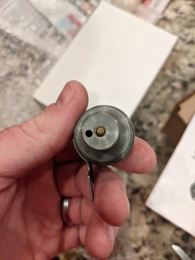

My NOS 2 hole solenoid came from eBay.
I dropped the valve body yesterday morning and replaced my old one and it is fixed!
Now when I flip my switch my TCC locks and RPM's drop like they are supposed to.
So the biggest lesson I learned from this is that the pressure can leak past the solenoid even if it is on or off. Basically it was a mechanical issue with my solenoid and that was causing the shudder.
My original thoughts where if the solenoid was unhooked I had eliminated it from troubleshooting, but that is not necessarily true.
Trans does great with the Transgo kit in it too. I highly recommend it if nothing but for the directions and exploded valve body diagram alone.
