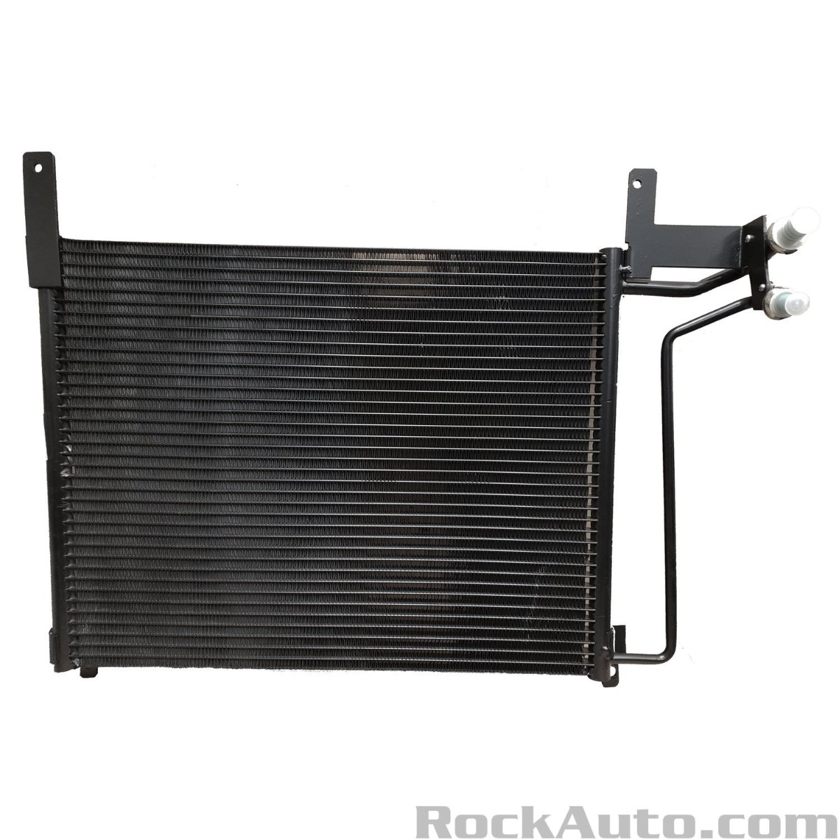

I am trying to install an AC condenser on an 85 Ranger that originally did not have AC, my question is are there mounting brackets or pads for the bottom of the condenser to mount to the radiator support? Can someone post a picture how the bottom of the condenser mounts to the radiator support.
I think I have found what I was looking for. The lower bracket on the condenser I bought was bent under, look like I just need to straighten it out and put u clip on it to bolt it down to the slot in the front side of the radiator support.

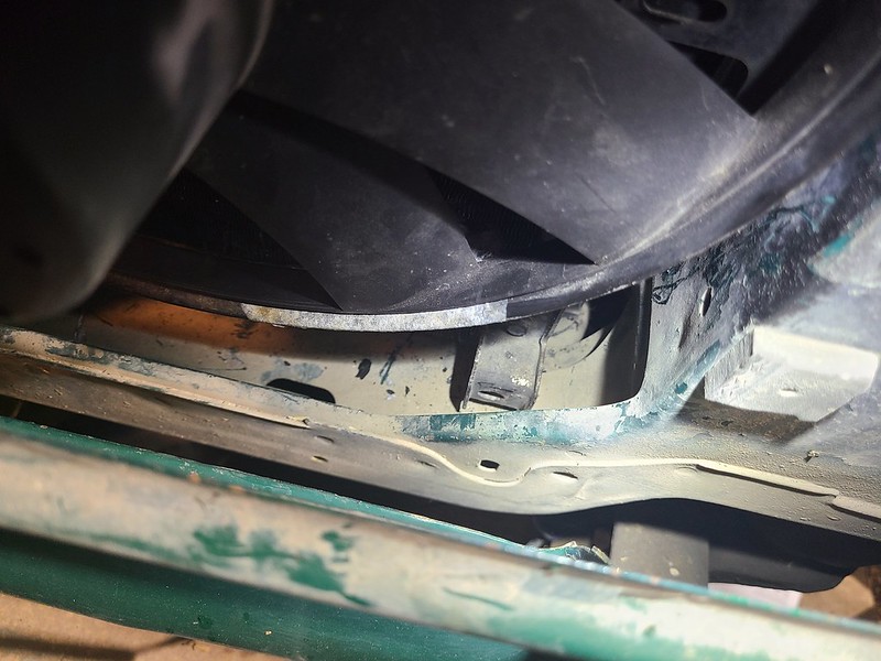

Pic from front, those tabs had clip nuts on them, I think the bolts came in from the engine side:

My mounting solution was brass bushings... because more weirdness imposed by the dual pusher efans.

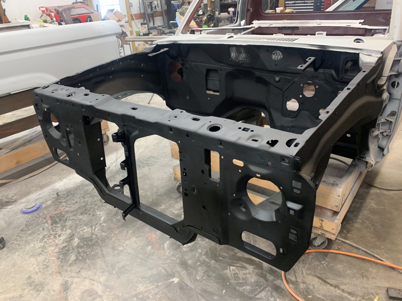

Thanks for mentioning about those rubber pieces, I guess I'll have to search the salvage yards to find them. My ranger is an 84 but I replaced the radiator core support with the 85-88 version, so I could mount the 4.0 HD radiator for the 5.0.

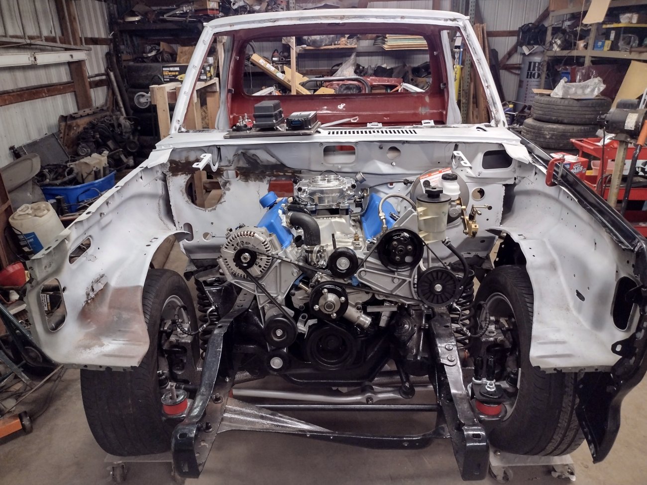

I used the Explorer compressor with a manifold and a modified hose assembly, I think off a 2.9. If you use a first gen condenser you have to run a hose from near the battery over to the compressor. With the second gen condenser it kicks the one port out on the DS so is right there for the second gen hose to to join.
You do have to do a little trimming to the radiator support for the condenser to fit.
I am using Explorer FEAD, I am going to be using Vintage Air Mini unit under the dash. my condenser is for an 83-89 Ranger. I have an explorer compressor and adapter to run vintage air lines

Here is a pic of the new 85-88 style radiator support after it was welded in and painted. I have also made a plate that will cover the holes where the old heater box us to attach. I will attach a fuse box and ignition box on that plate.
