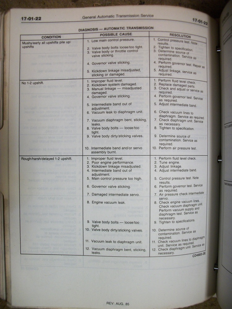

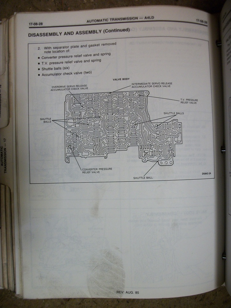

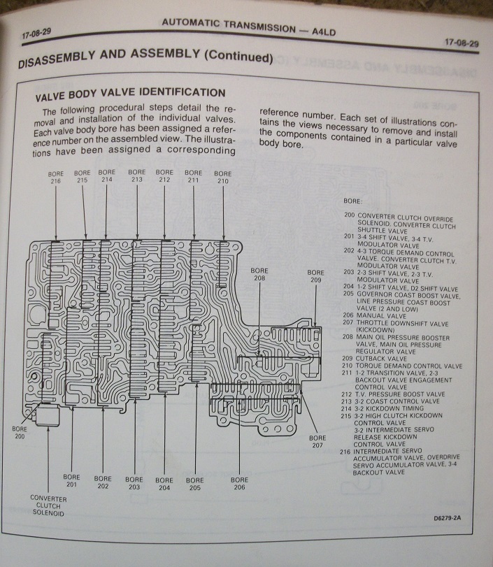

See if these are any help. All from the Ford 1985-86 Ranger / Bronco II Truck Shop Manual. First, diagnosis steps for "No 1-2 upshift", then two following pages showing small parts, and valve assignment in the valve body. I'll dig out more as time permits, and also ask the trans shop if there's anything specific that would help them. I don't know what tech resources they have access to, and as pointed out these transmissions are now antiques, and a lot of shops won't even work on them.

It just occurred to me that we had problems with the shuttle balls wearing down and passing through the holes in the valve body in C3 transmissions. The A4LD, 4r44, and 5r55 are all descended from the C3. If any of the balls are worn undersized it would cause problems.
