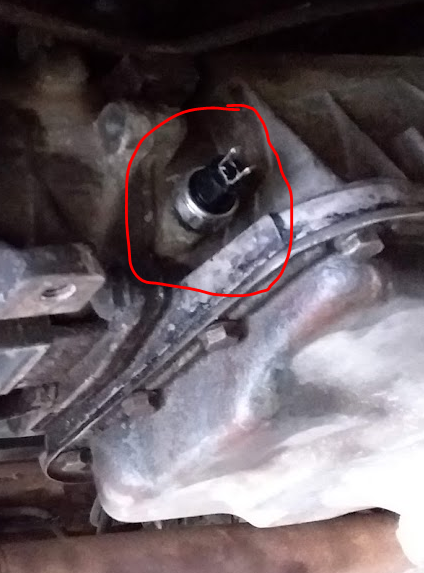

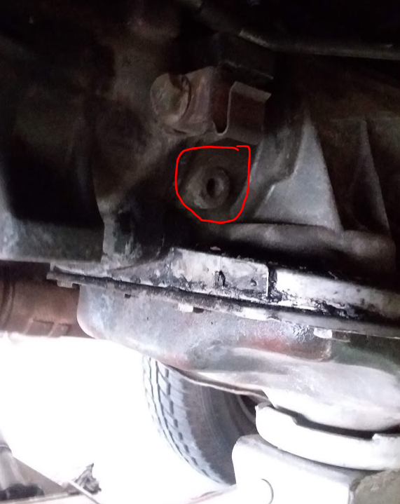

Pictures as promised. The first one is of the boss, the second is of the switch installed.

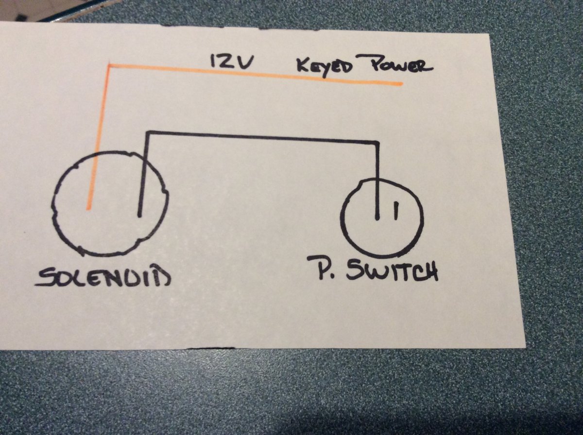

You should have 1 wire going to pressure switch not 2. Be careful tapping into wires for computer. Very easy to back feed or short out and destroy the computer.
Thank you for the diagram. I will correct my wiring and try again.
