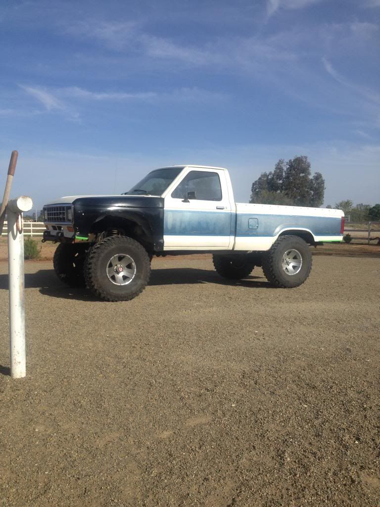

here's how the truck looked when i bought it.

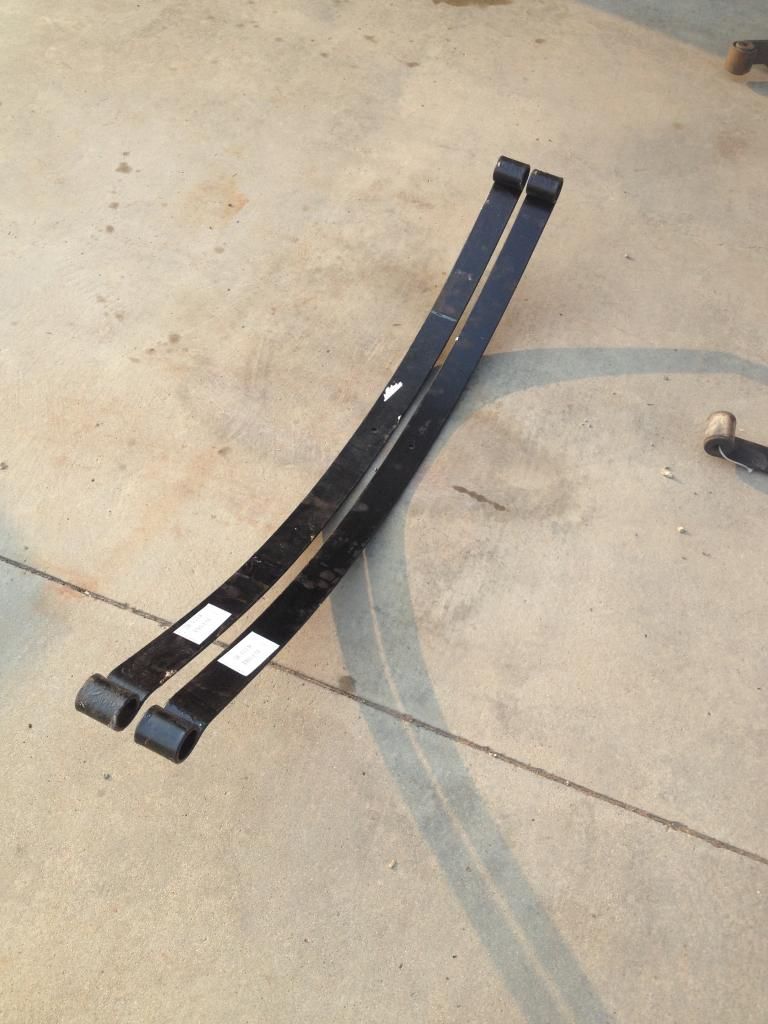

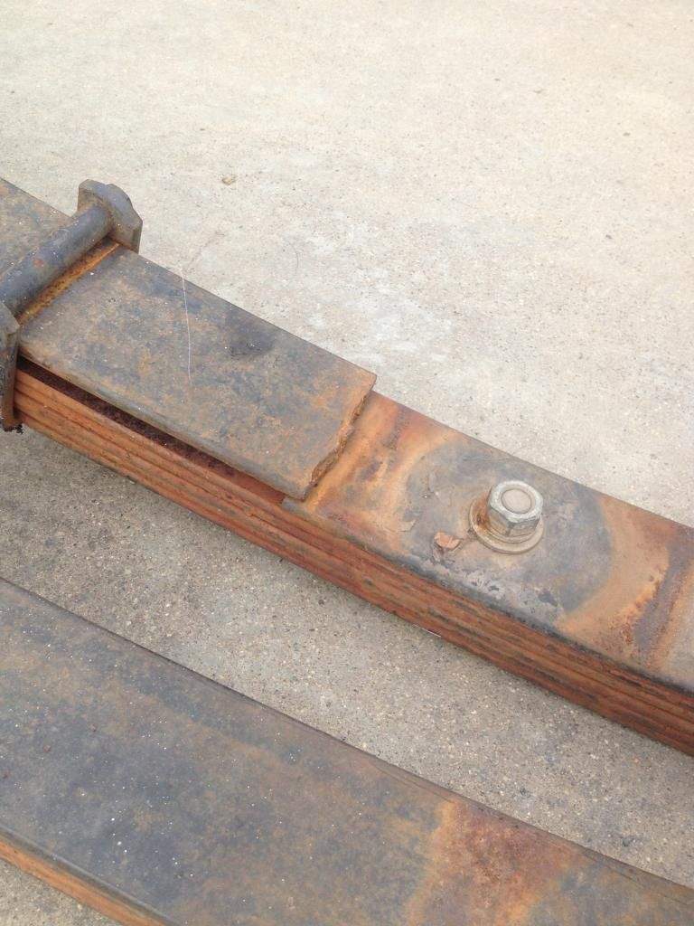

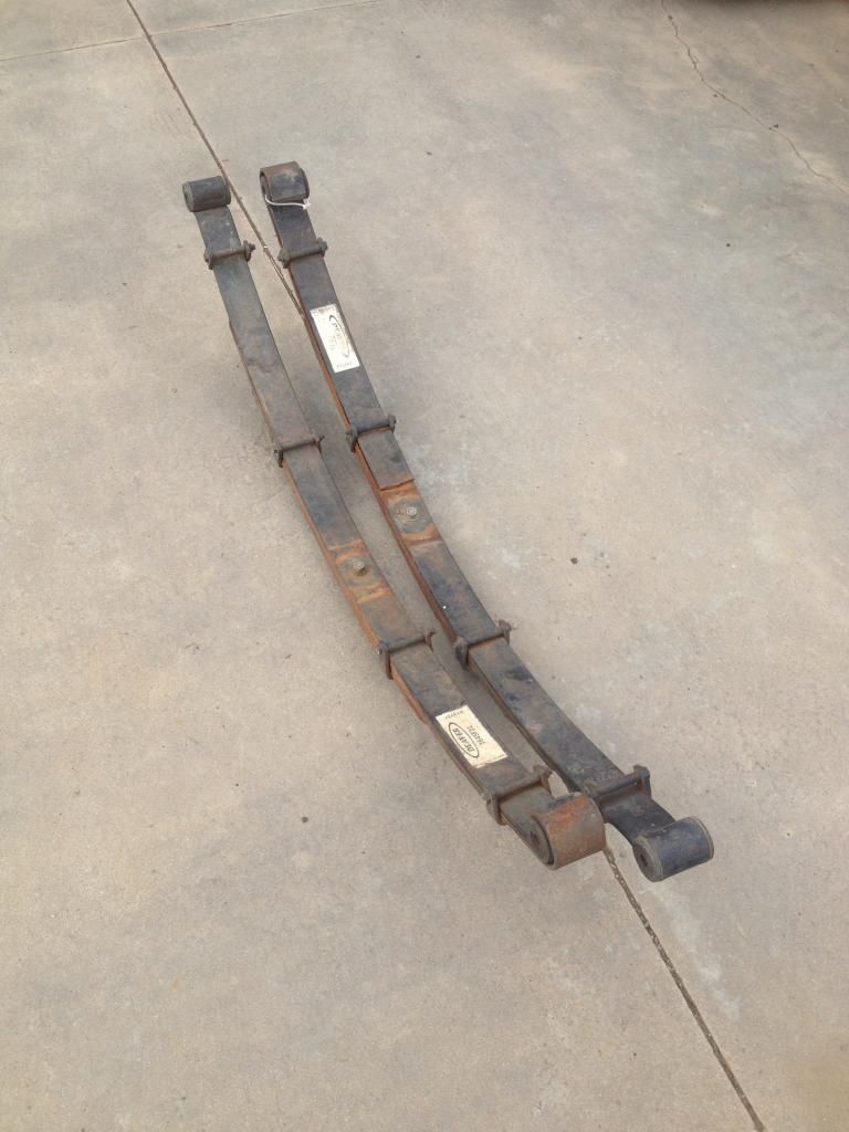

i picked up some used deavers with a snapped main leaf but the price was right.
snapped main leaf

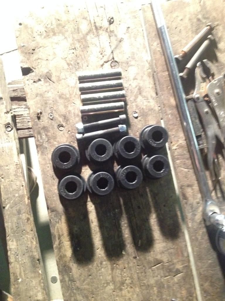

i decided to replace both main leaves while i was doing the one. i also got new bushings and center pins.

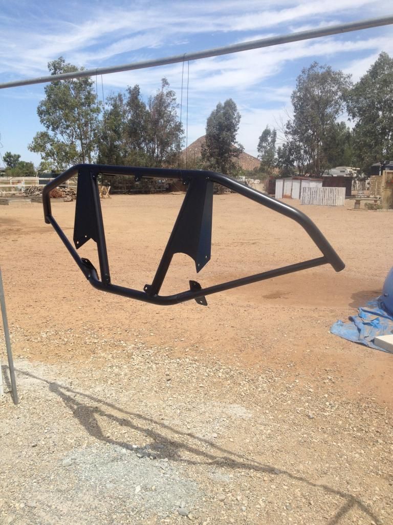

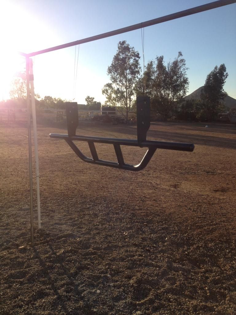

and decided to give building a rear bumper a shot.

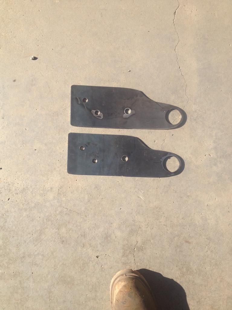

rear bumper brackets made out of 3/16" plate
and what i came up with for the rear bumper, i was trying to keep it simple. i'm not 100% sure i like it so it might not stay on the truck for too long.

Looks good.. Whats under it? 35 inch tires?
it had some huge drop brackets and i'm assuming an 8" lift up front with 35's.
I finally got around to adding some end caps to the bumper and got it painted

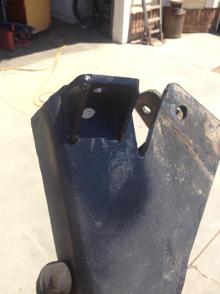

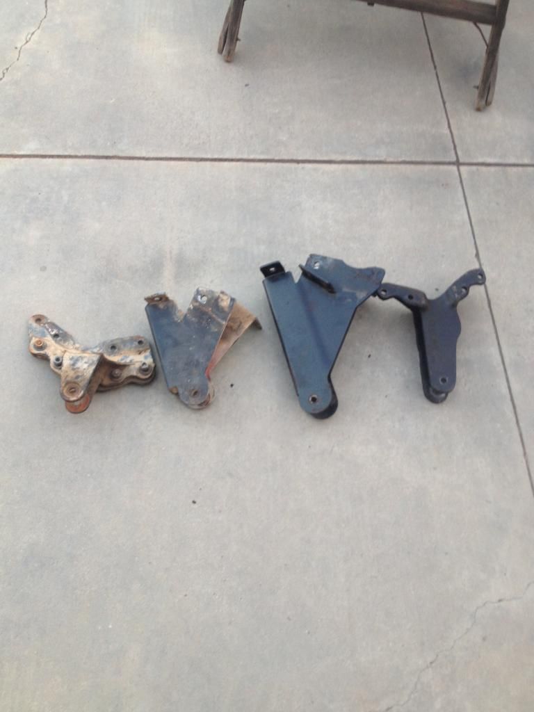

i picked up some smaller drop brackets for $50 not sure what drop they but there better than what the truck came with.
the brackets the truck had when i bought it are on the right
one of the tabs on the old brackets was broken when i took them off so i gusseted the brackets i bought before i bolted them up.

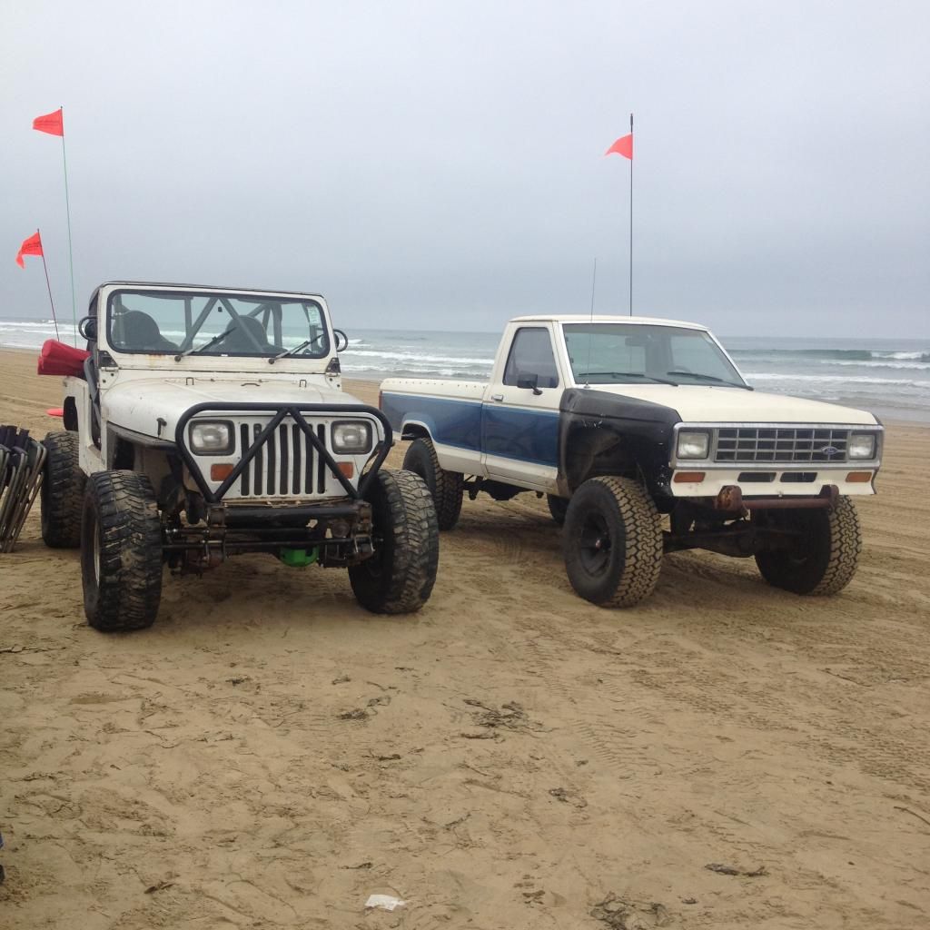

i cut down the 6" coils to drop the front end down to match the rear and threw some 33's on there then i took the truck to pismo last weekend and had some fun. unfortunately i didn't get any action shots.
That looks like an awesome place to go!
Looks good leveled out too. I'm hoping to put new springs on mine to hopefully level it out a bit. Both front and rear are getting pretty saggy.
