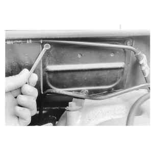

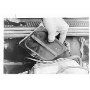

Remove the linkage access cover retaining screws ...
... and remove the cover

  3. Remove the linkage access cover, located on the right side of the dash panel near the wiper motor.

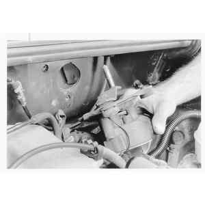

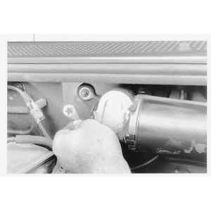

Reach into the access hole and disconnect the wiper motor linkage clip from the motor shaft
Remove the clip. Also, remove the linkages from the wiper motor shaft
  1. Reach through the access cover opening and unsnap the wiper motor clip.
  2. Push the clip away from the linkage until it clears the nib on the crank pin. Then, push the clip off the linkage.

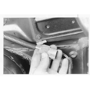

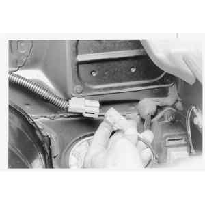

Disconnect the wiper motor's wiring harness plug ...
... and remove the harness from any holding clips

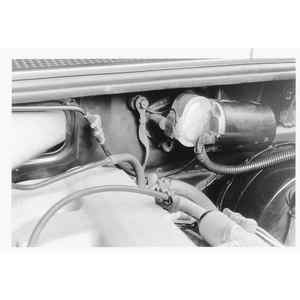

Remove the ground wire retaining nut ...
... and the ground wire from the wiper motor attaching stud
  1. Remove the wiper linkage from motor crank pin.
  2. Disconnect the wiper motor's wiring connector.

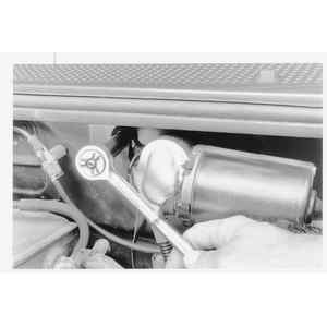

  3. remove the wiper motor's three attaching screws and remove the motor.
Remove the three wiper motor-to-firewall attaching screws ...
... then withdraw the wiper motor and crank assembly from the firewall
