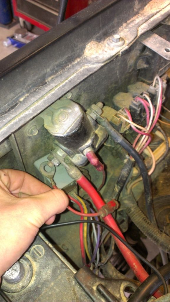

The engine not turning over is a problem with the starting circuit, not the ignition system. My first question to you would be, when you turn the key do you hear a clicking under the hood? The clicking I'm talking about is the starter solenoid which is basically a very big relay closing, every Ranger I've been around this has been audible when working. If you do hear the clicking the solenoid is good and problem lies elsewhere, most likely in the wire to the starter or the the engine ground. If you don't hear a click it means either the solenoid is not working or it is not getting power. This is or should be similar to the starter solenoid in your Ranger.
The two larger terminals go to your battery and starter. The smaller terminal is the start trigger for closing the relay when the ignition switch is used, it may be labeled with an S. There may be a second smaller terminal which would be used for ignition if wired that way, it would be labeled with an I and for our purposes it's not important. There's a quick and easy way to test these solenoids without a multimeter. I'll list the steps below, read all steps before starting.
Instructions:
  1. Read all of these instructions and follow in order. I don't want to be thrown in jail for you failing to follow instructions
  2. Disconnect the coil wire going to the distributor.
  3. Find a plastic/rubber handled screw driver. The thicker the handle the better, preferably no exposed metal on the handle end.
  4. Short the screw driver across the large terminal connected to battery and the start trigger. If you hear clicking or the motor turns over stop here cause the the starter solenoid is good. If nothing happens continue to the next step.
  5. Make note of which large cable connects to which terminal (should be same as image above), then disconnect both large cables from the starter solenoid.
  6. Holding the cables by the insulation, or if possible use the screw driver again, touch them together. If the engine turns over replace the starter solenoid, and reconnect your coil wire.
Disconnecting the coil is an important step because we will be bypassing the ignition key here, we do not want the engine to fire if it does turn over. The insulated handle screwdriver is very important for your safety, I don't want you getting electrocuted here.
If step 3 is successful that means that your starter solenoid is not getting power when you flip the key to start, you need to check out that wiring to find where power is being lost. For this next part I'm assuming you have checked out the battery to make sure it's good. If in step 3 you have a clicking sound and the engine does not turn over it means a wiring problem between the solenoid and the starter, a bad starter, or a bad engine ground. You can pretty much expect the same thing in step 4 if the engine does not turn over. In either of these cases your solenoid is most likely good.
