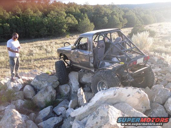

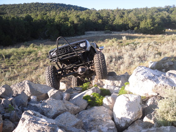

just some playing afterwards Sceeps rock pile.
dont let it fool you, this is a mean rock pile, same pile that has broken lots of D44, D60 and 14 shafts... and flopped Nates buggy... hehehe
