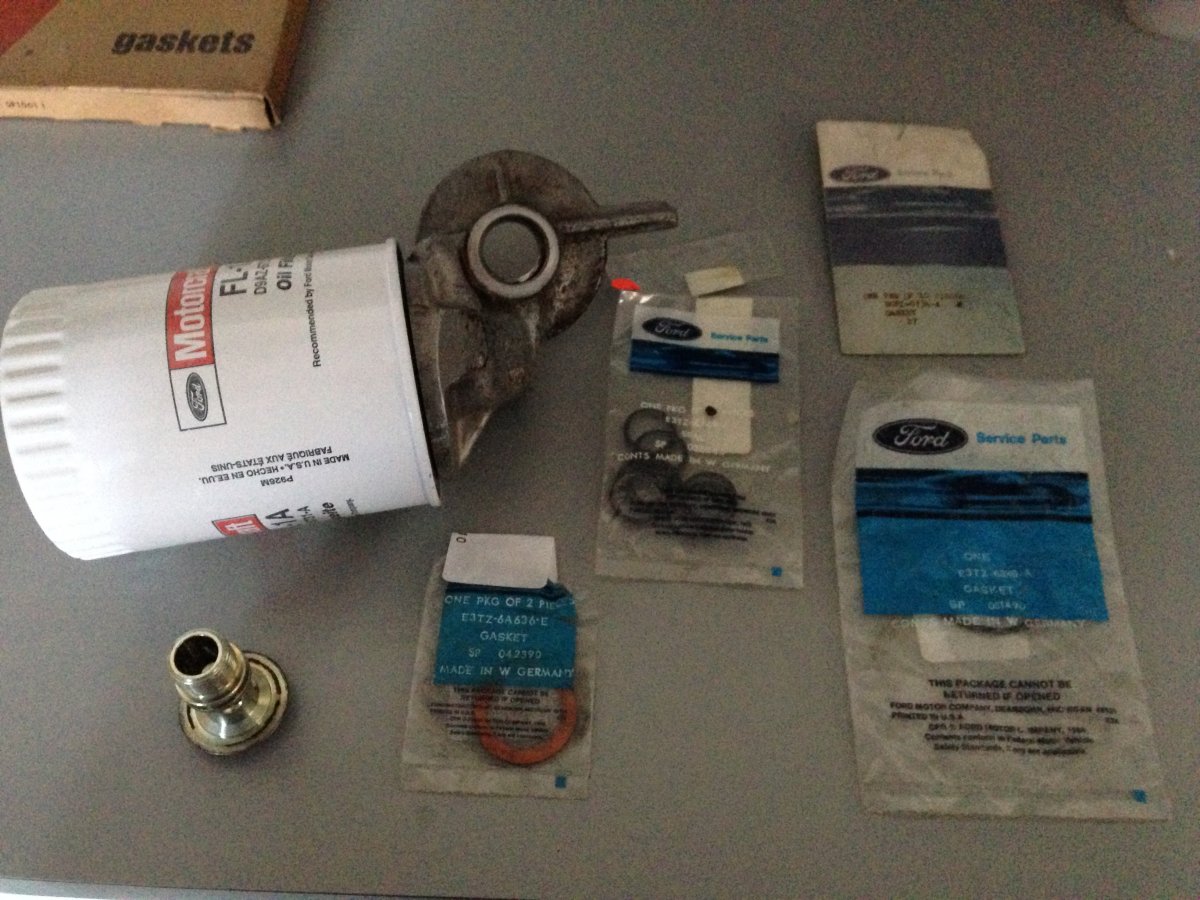

84 2.8 leaking from oil filter or somewhere near/around it. Oil filter has droplets of oil when the motor is off.
Ill see about buying a SAE kit as well. Since My stuff isn't really complete sadly. I also need some new stuff anyway.
It’s metric.

Thanks! A LOT!!! Never seen it off like that!
Ive got fel-pro O-Rings. Do I need to replace the copper washer? Also, What size is it? Just so I know what I need make sure I get.
I would replace the copper washer. I don’t remember was size the bolt head is.

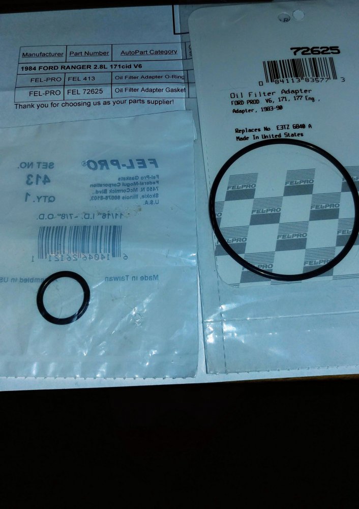

These are the O-Rings I got. Rock auto only has these... Whats the part number for the copper washer so I can try and get it.
Both times I just re-used the copper washer. No one had it, and in my experience they are re-usable unless they are really tore up.
I can't remember what size it was, but maybe it was a 18mm from what you are saying. You can't beat a metric wrench set that has ALL the sizes from 10mm up to 19mm. I find myself using the odd ball sizes more often that I would have thought. 18mm is a oddball size, as well as 16mm. But the set I have has them all in 1mm increments.
For anyone that may need to know, I damaged my thrust washer when reinstalling my oil filter adapter on my 83 2.8 ranger. The washer can be replaced with Dorman- HD solutions copper drain plug gasket #095-5002CD. I found a 3 pack on Amazon for $14 but looking the part up on the Dorman site it seems to be used pretty commonly on big rig diesel engine oil pan plugs so I would imagine you could find them at a truck shop or diesel parts supply.

Here's some pics and specs for the 2.8 oil filter adapter from the same thread. I ordered the Felpro 413 O-ring recommended in the thread but found that an O-ring assortment pack from AutoZone had a better fit and are Viton, not rubber, so should last longer. When I replaced my rubber O-ring, it was hard and brittle. It crumbled when I tried to take it off. So Viton may be a better choice.
On AutoZone's site just search for Dorman Viton Standard O-Ring Assortment 18 Piece.
