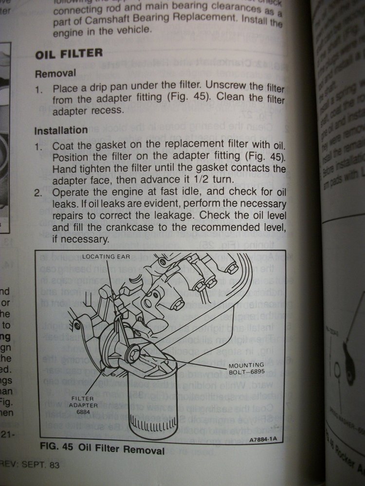

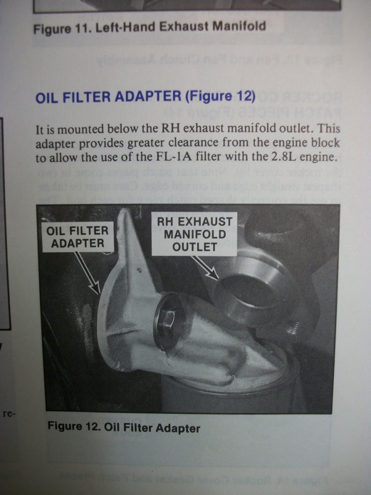

Well, I checked what Ford manuals I have, and there's nothing specific on the R&R of the filter adapter for the 2.8L.
I don't know if you can clear the filter adapter's sole mounting bolt with the exhaust Y-pipe in place. On a 4.0, with the Y-pipe dropped changing these O-rings is easy; but believe me, I do know that dealing with old exhaust bolts can really suck a big one. The bolt is hollow, so go easy on it; its torque spec is listed as 15-30 ft-lbs.
Good luck!
1984 2.8L intro training manual:
And the 1984 Ranger and Bronco II shop manual:
Thanks for looking through your books to find this! It helps a lot!
It looks like Im gonna have to remove the pipe coming off the manifold to get to the bold. Im gonna have to wait to do this as Its supposed to rain today (At some point) and tomorrow.... So Hopefully I can get this job done quickly and painlessly. (Thats a small sliver of hope lol)
