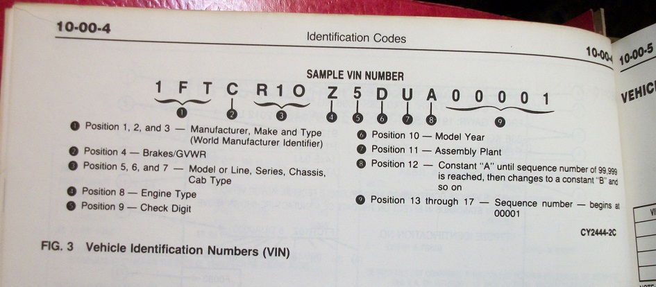

Here's the VIN breakdown for the 1983 and '84 models:
57930
I think that yours may be an early production Ranger, if like it appears in your pictures the top dash panel having just a single mono speaker location. If I remember correctly, the first ones came in having just the one speaker location, then came a period of three speaker locations (retained the 1 center for mono and added 2 outer for stereo), before the dash panel standardized later on with just the 2 outer speaker locations for both mono and stereo.
The first Rangers were built starting in January 1982, with sales starting in March of 1982 (as a 1983 model). The door sticker, if still legible, will have a month of manufacture, and of course the VIN sequential will tell you how early it is. Build dates were stamped in ink on the front passenger side of the core support, and in some cases they can still be found and be legible enough to read.
Clean stock early Rangers are getting rare. I can't wait to see this one running again!

Wow thank you! It’s interesting you mention about the speakers, because I noticed when I got power to it, and the radio turned on, it sounded so bizarre to me as it was only coming from one central speaker.
I will check for month of manufacture and the actual vehicle VIN today and let you know!
it would not surprise me if it is a first production run model as the farm hand had mentioned the owner loved going and purchasing unique vehicles at auctions in his prime.
