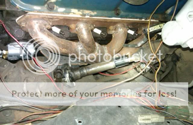

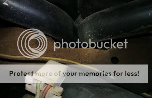

here is what i came up with for exhaust, i kind of suck at welding so bear with me here:dunno:
Hey man dont look too bad, better thn alot of other custom modded headers ive seen

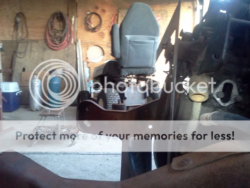

ok now that i have learned how to post the large print pics. here is the pics i was unable to post before because of there size. they span from the start of my build to where i am now.
first time fitting her in with front slump oil pan:icon_confused::idiot:

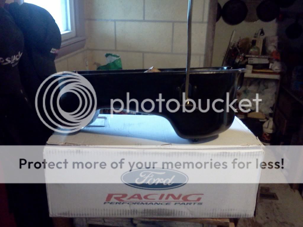

after i was done being stupid by trying to fit her in with a front slump pan and lots of online reading of what to use, i ordered a new dual slump pan from jegs.:drool:
83' Ranger 351w Project

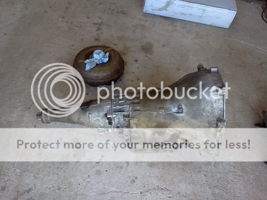

at the time hoping theres enough room for a C6 back there
after about two months of wait for my brother to rebuild and install a transpak kit from B&M in my transmission i got it back but i cannt complan to much labor was free:icon_thumby:

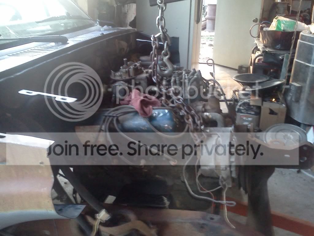

holy cow it fits:icon_surprised:

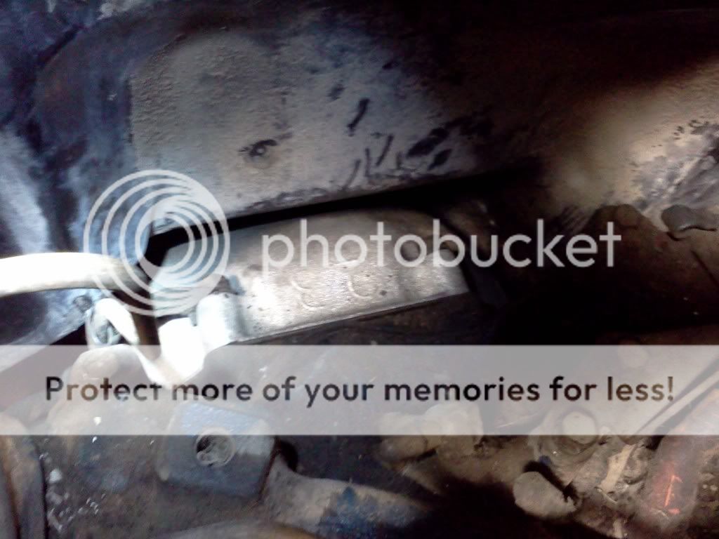

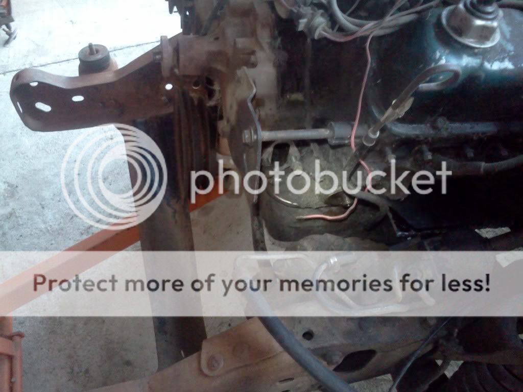

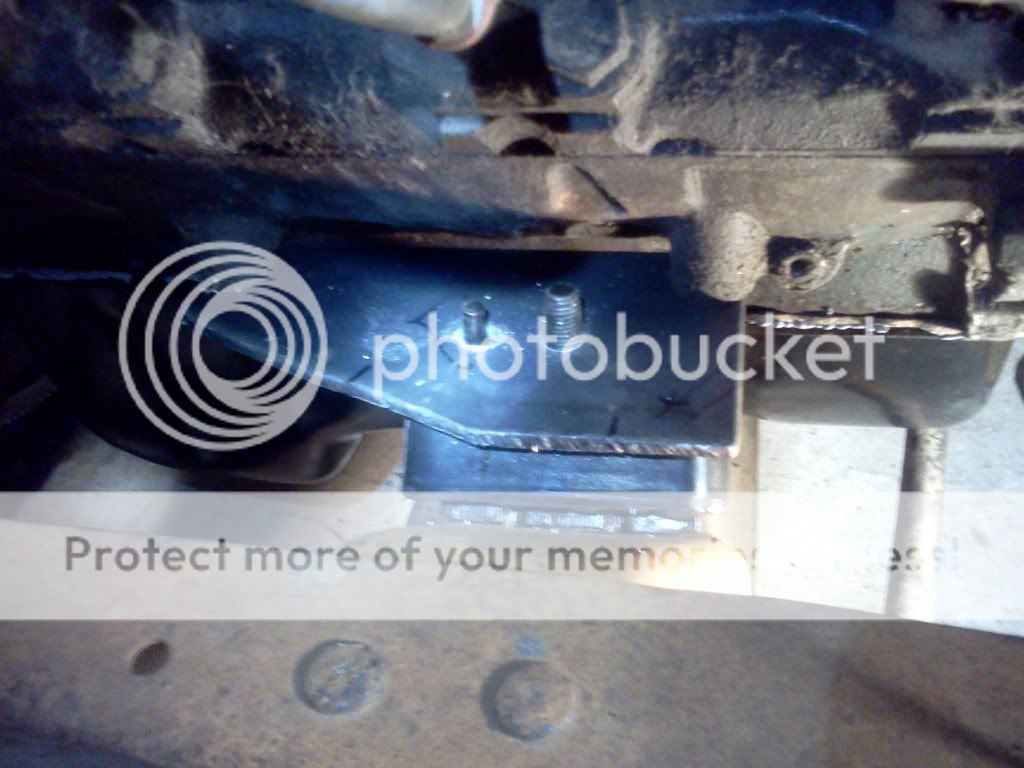

as you can see i went with the V6 mounts and home made plates:icon_welder:

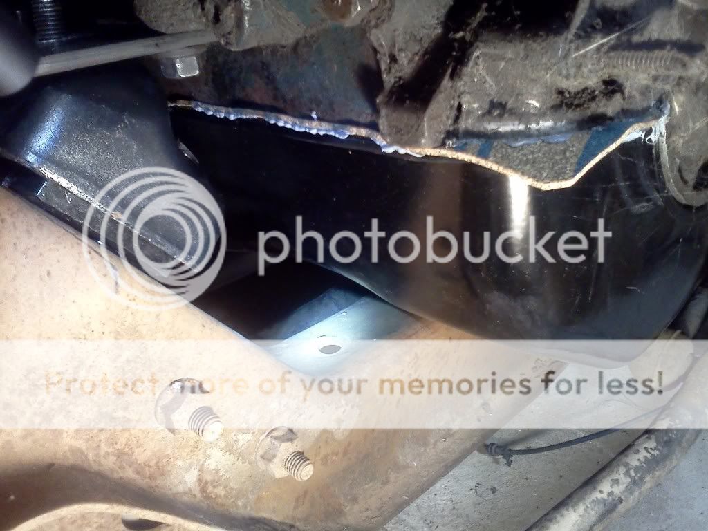

Now for the exhaust on the passenger side i use the passenger header jegs sells with the 302 swap kit, just need a notch cut out of the frame to fit

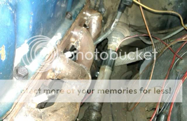

the driver side header is a total different story, i made it out of an old 302 header that came out of my dads 93 f150 pickup that had been hit. this was my first time welding together any kind off header.
only sad thing about this header is it has to be putt in from under my truck:bawling:all because of the ball flange i used.

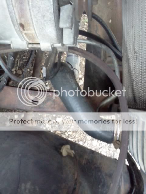

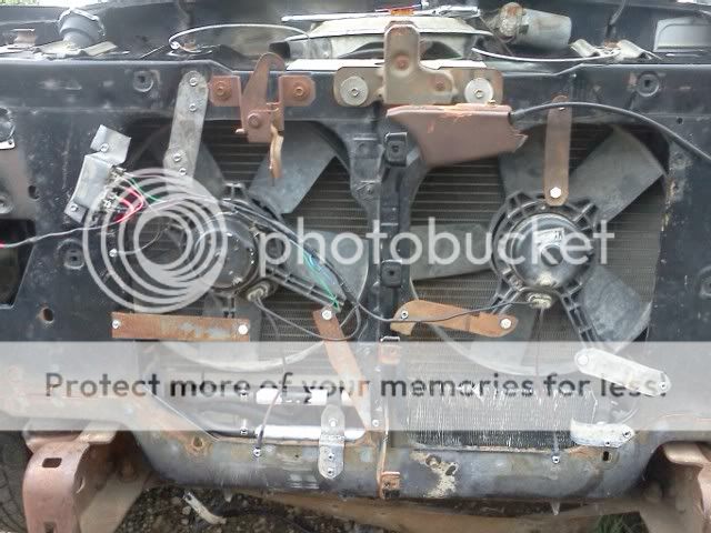

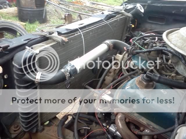

for my radiator i used one form a pontiac grand am and the fans from it

Any pics of radiator and fans installed?

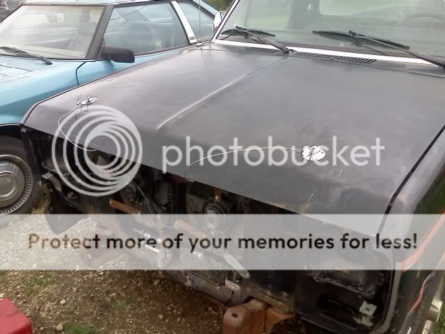

hood pins anyone:headbang:

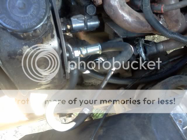

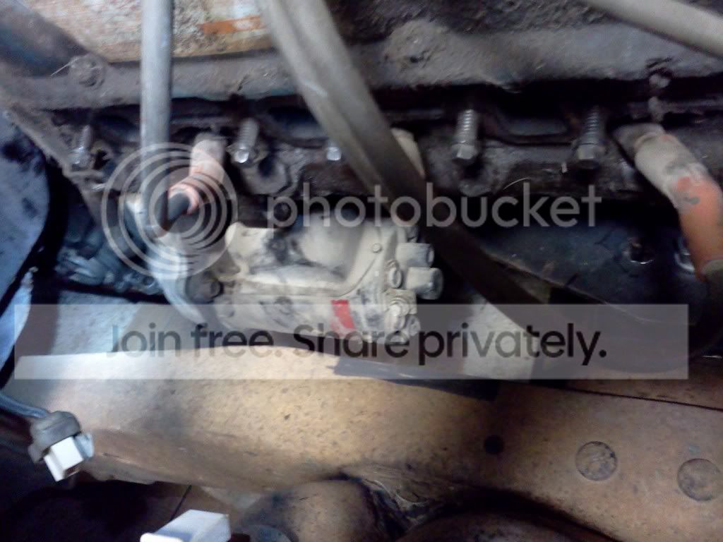

power steering all hooked up
