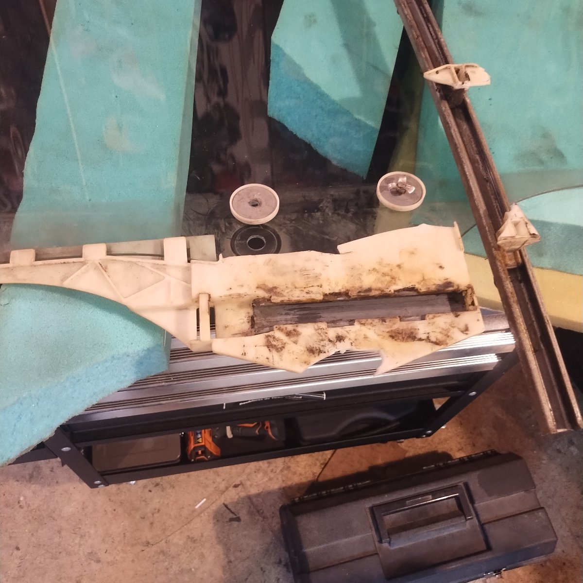

hey all. the plastic support for the window holder broke, have it all apart and after seeking a replacement, went to my 85 parts door and there was a metal one in there that i was able to remove and looks like the same size of holder. my question is about the "rivets" that hold the window into the holder. I want to use bolts and double nut/lock tight the bolts in where they used to be rivets. has anyone had a problem with the "bolts" yes i understand the need to be movement in the holder. cheers
  • 83 drivers window support replacement
As long as it doesn't stick out too far and catch something in the door it should be fine. I'd probably just use ny-locs.
hi, thanks for reply. after a "google" search of ny-locs comes up with ny - new york, and locs in hair .. i am not sure what your referencing. lol cheers not familiar with the term.
ahhh got it nylon nuts ... damn i can be un thinking at times... lol
