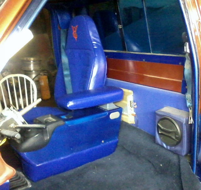

Been slowly chewing away at this as time allows... work has been busy and tired after work to get out and do stuff...
but slowly doing the last of the wiring and all the small stuff that doesn't make any pictures.... BUT.... here is the cab one step closer... seats in and console finished. wired up and ready to go.
changed the wiring a bit from before. there are 2 REM switches, 1for the power amp and 1 for the radio. then a separate wired in set of plugs for charging phones and stuff instead of the cig lighter, wired direct.
still need to wire in the fuel pump and finish off the fans get back brakes done and to the shop for a new drive shaft measured up.
cheers

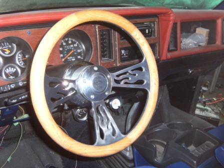

Yes a few things to update on. did a bit of work over the winter when the temp allowed to be out with out freezing fingers tips.... finished the fuel pump installation, finished 95% of all the wiring, placed on new locking handles for the cover, finished the passenger side door (hung with new hinge and carpet/new sill) still need to do the pass locks and mirrors. driver side ready to do the hinge pin and door/ sill. needs to go on trailer to drive shaft shop for measurement and fitment. needs back brakes / park brake. ... still need to finish the speaker covers along with the under tonnau lighting. shortened the tail gate straps at a wire/rope shop. to give the opened tailgate a angled look when open and to hopefully prevent people from trying to sit on it. finished the turn signal mods. (never did a re write up on it) should though for others to experiment. need to get angie to finish the new recovered door skins and get them on eventually. hopefully i can fire it up and drive it in a couple months. work is busy and days seem too short now from when we started this project.
cheers

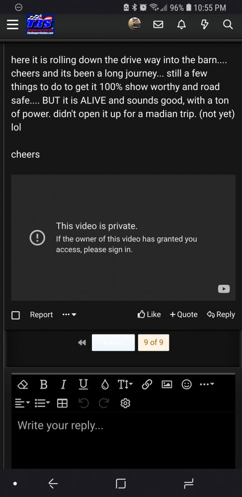

here it is rolling down the drive way into the barn.... cheers and its been a long journey... still a few things to do to get it 100% show worthy and road safe.... BUT it is ALIVE and sounds good, with a ton of power. didn't open it up for a madian trip. (not yet) lol
cheers
Glad to hear the good news. Unfortunately I cant see the video...
83 302 build
dam... check back in a few, angie is working on how to make it live and not private. :(
