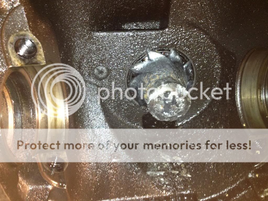

Hey guys in a bind (pun intended :) ). Searched the whole site for a "like" thread and came up empty handed. Also, I have read just about every 8.8 rear end setup guide out there and they all pretty much say the same thing "Measure your previous pinion and go from there". The problem as you can see in my build thread is the previous pinion got DESTROYED :(
The top of it is not round enough or straight enough to take a good measurement.
So I need a little guidance on how to start from zero. I have a brand new FRP 4.56 Ring and pinion to go in. And the rear end is now disassembled, cleaned, and even repainted. Just dont know how to start with nothing

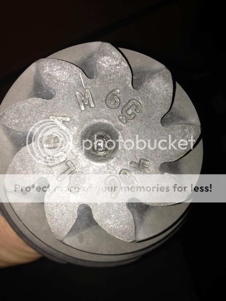

ok guys need more assistance on "guessing" since this is my first time.. finally was able to beat the remaining gear teeth back far enough to press the bearing off the old pinion.. The shim is damaged "go figure lol" it reads between 31.5 and 34 taken from many many reference points.. I am going to go out on a limb and guess it might of been a 32 mostly because of all the build threads I have read but whats your take?
Also there are numbers on the end of the new pinion.. the ones I dont understand are the 6 and C stamp.. Anyone know what that signifies see below for pics.

In that exact situation I would remove the "Dead" pinion
and being careful not to rease the paint marks on the shank
Typically +2, +1, 0, -1 or -2 would set up the new pinion according to the original
