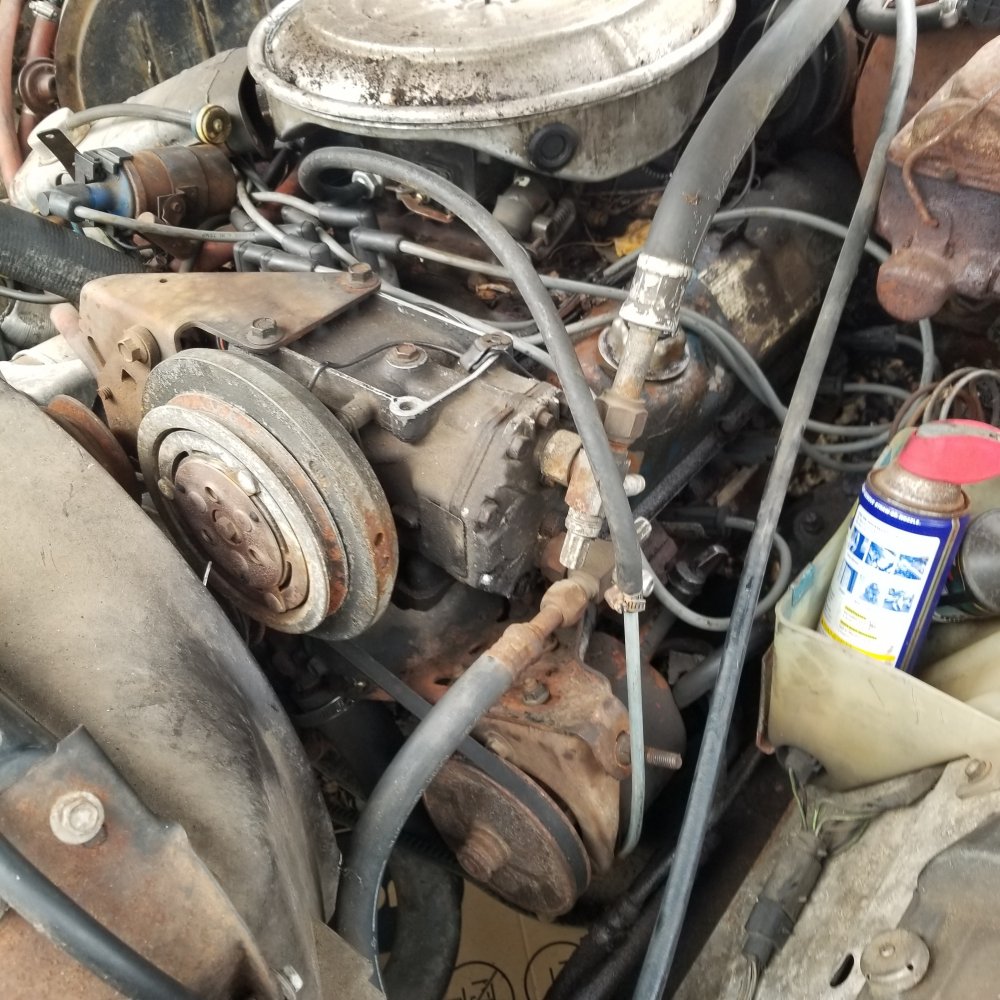

Only other possibilty i just thought of was i had to change the metal line from pump to carb, i couldnt bend it properly to run it up back by the water pump like it was factory so i just did this....
But its not kinked or restricted in any way.
