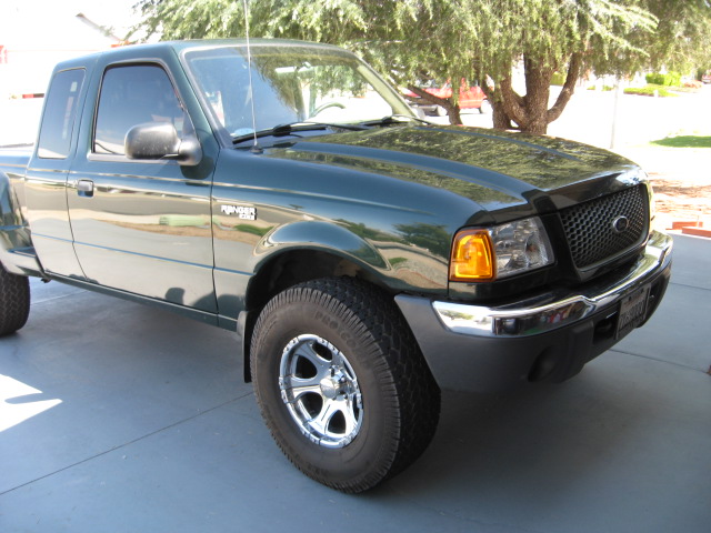

YEA !!( I think,) I got it anyway, BTW it only has 16" rims and pro comp 285/75/16 tires, Don't know where he got the 17" in his add, and they looked big to me and I didn't check untill I was ready to buy, Took my GPS in it for a test drive, and it was only off 5 MPH, slow, so will know more about the susp. when I get it offroad,the 4lo light on the dash doesn't light up, the 4wh light will light, just tried them at a stop, not moving, what do you Think ?? something expensive ? anyway offroad, how would I really tell if it was in 4lo or 4 hi? maybe the RPM huh? Hey, all you guys have been really helpful and I really appreaciate It !! I know I will have a lot more questions to come, as my first Ranger, I have to have a good 4X4 as we will be going out on the desert alone, my SO. and me, and if I can figure out how to post pics I will !! Cowboy701
PIC maybe !!
Hope this works !!

Looks like a nice clean truck :icon_thumby:
