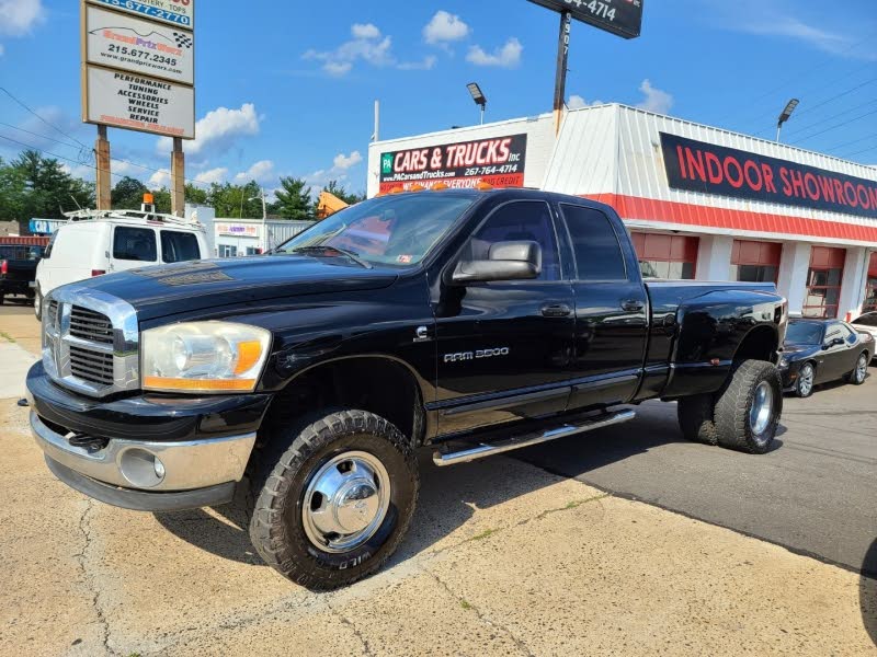

This was the winner:
5.9 Cummins High Output Common Rail
6-Speed Manual
CC LB DRW

That’s a nice Cummins shipping crate... now you need to find a Superduty to put it in.
6-Speed Manual
CC LB DRW
The 5.9 Cummins is the best choice you coulda made. Espicially with a 6speed. Smart descion.
Ive never owned a 6.0...never plan to. Honestly i wouldnt own any Ford diesel truck except for a 7.3PSD or a IDI 6.9/7.3.
Rusty's idea of the perfect vehicle....
