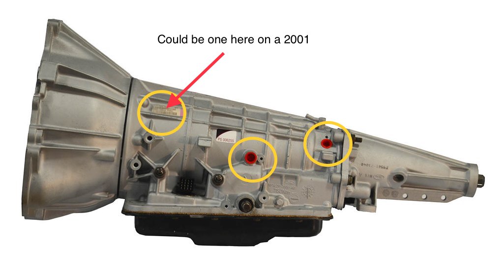

2001-2011 are the same unit. 2002 had a extra sensor that was used for that year. Will still work if your harness doesn’t have the connection for it.

Will I need to change any of wiring harness or will the late model 5R55E be a clean swap out into my 01? Thanks for the assistance! I found and liked your Facebook page. I'm the maintenance chief here for our local fire department. We have a guy in our training division that worked for the Morgantown fire department.
Sorry for the questions Brad! Will I need to have the donor trans programmed? Thanks again!

No programming, here is a picture of the possible sensor locations. Does yours have any like this?
