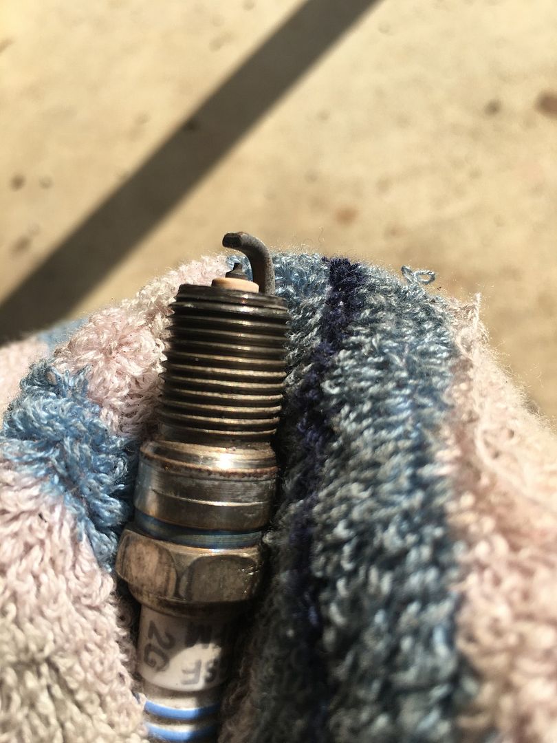

Cleaned the MAF, added firewall to engine block ground strap, checked air filter, and pulled a spark plug. I pulled the plug out of the cylinder on the passenger side closest to the front. Here are some pics. Does it look like excessive carbon buildup indicating a rich mixture? Never really examined plugs before... Also no oil or gas came out when I pulled the plug. I'm running out of ideas. I can pull my chip and see how it runs, but I don't know if that would get me anything. It's still not going to run right if it's looking for auto tranny.
