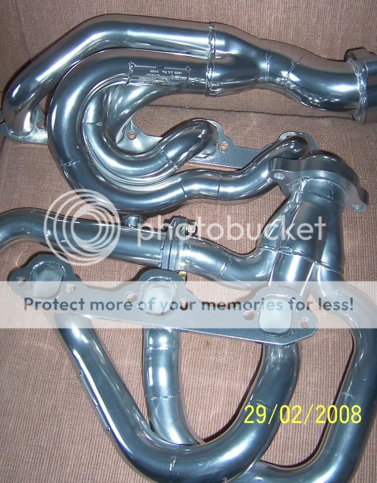

There really is no problem with puttng the Explorer 5.0 into the later ('98 and newer) Rangers. A 351 is a whole lot different. Only 5.0 headers that are worth getting, especially if modifing the motor, are the $750 Torque Monster headers and they are only 1 1/2" tubes but good up to 350-380 HP. The guy does some wonderful work, my next set is coming in on Friday to fit my AFR 165 heads.
