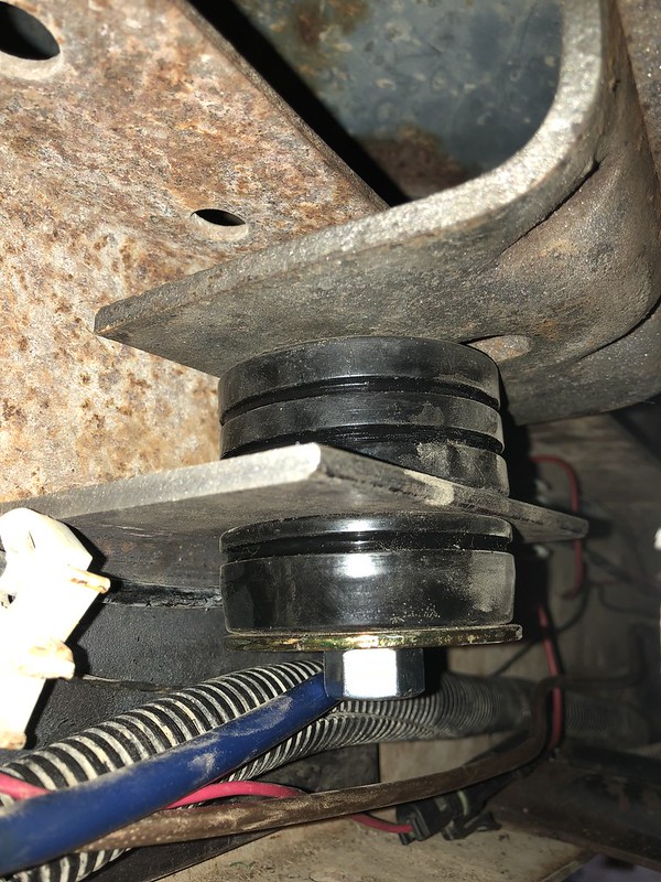

I’m running a 205 behind my ZF. They fit between the rails and are shorter than the 1356. Like Elutheros said, it’s recommended to add a crossmember and bracket to support the tail of the 205 due to its weight. They are a little noisy compared to the 1356’s though.

NP205 isn't much bigger than the stock BW t-case.

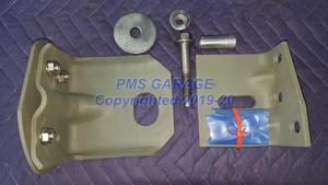

I just used a chunk of substantial angle iron and a bushing kit from Bronco Graveyard for my mount.
That is basically what they did from the factory but they had to reach alot farther out to get to the t-case since the frame is wider (left bracket goes on frame, right goes on t-case)
