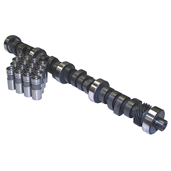

I bought a cam for my v8 Bronco 2 several years ago and never used it. Brand new in box. I need help deciding what kind of performance cam it is. .473 valve lift. .497 exhaust lift. .288 duration int. ..300 duration exhaust. Anyone know what I have? It's for a Ford 302
That is this exact camshaft.
Here is the Elgin catalog. It's located on page 23 of this pdf. https://www.elginind.com/wp-content/uploads/2021/11/Elgin-ProStock-2022-Catalog.pdf
It is colored "yellow", Not the best for low end torque or off-roading unless you keep the stock 3.73 gearing. It's good for 2000rpm and up.
Not really going to be for off roading. Some, but mostly a daily driver. Don't remember exactly why I thought this one was a great idea. Thanks for input
