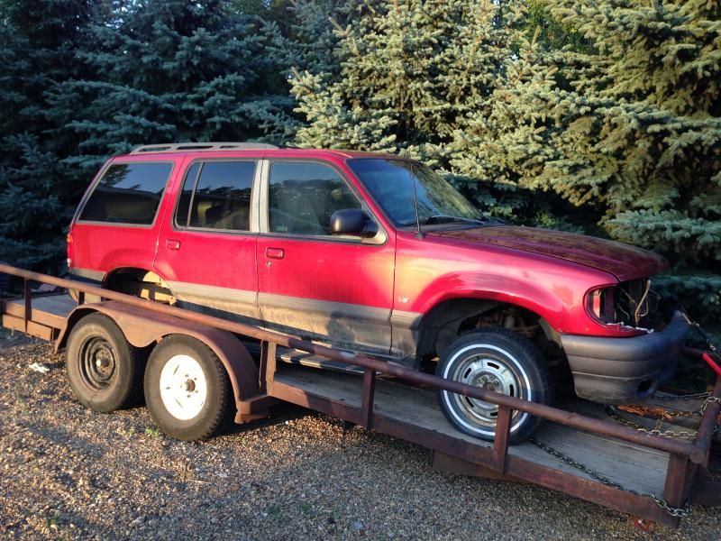

Found a 1998 Merc mountaineer minus the rear end for $300
Pulled motor/trans/tcase 5.0L, 4r70W, and whatever the stupid AWD tcase is

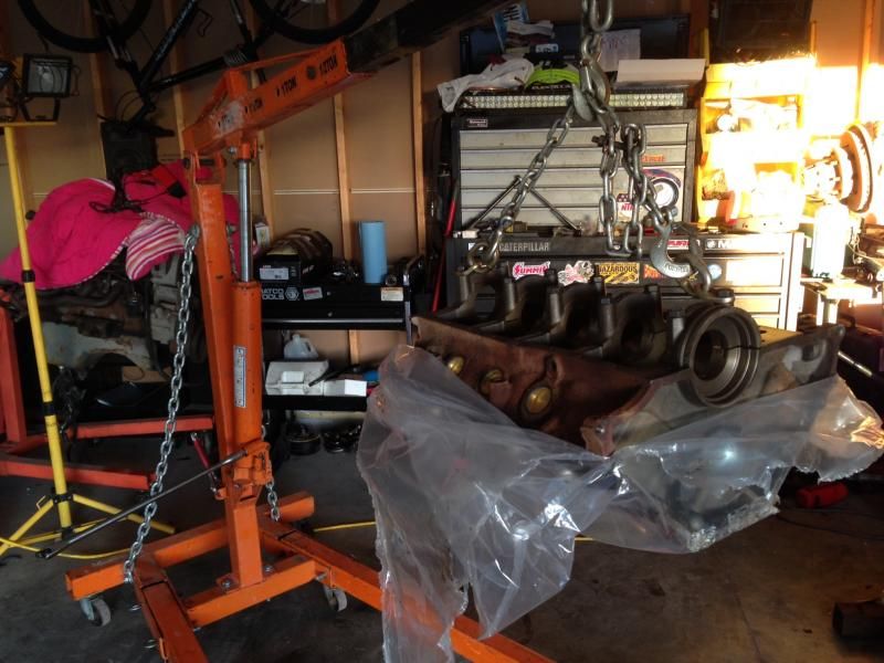

Sent the block off! Bored .030" over, GT40P's got new valves, dual springs, hardened pushrods, ported, Forged AL pistons, ARP rod bolts, ARP headstuds, mild Comp cam. This is a shot of the block coming home

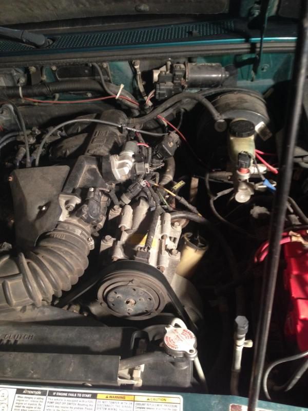

Time to pull this POS
Found some new friends in the airbox
Had some extra off-road lights sitting around, damn they came in handy!!
Got her out

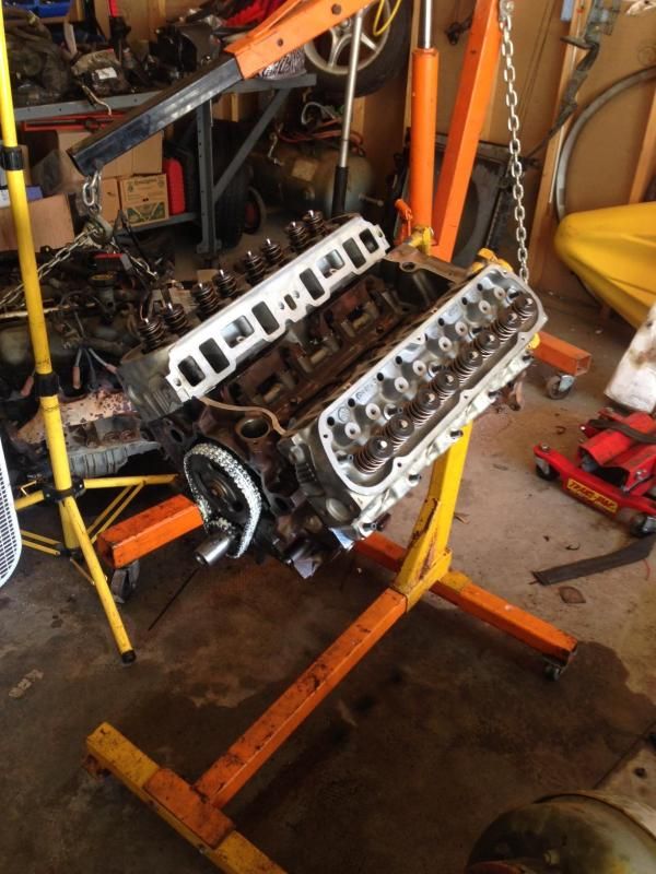

Shortblock timed, ARP's getting installed.
Long block assembled.

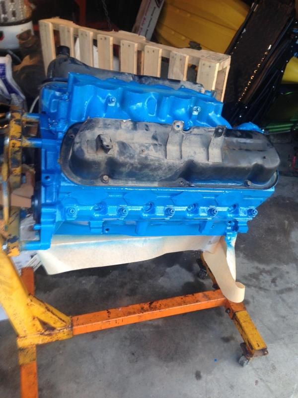

Shot her with some ford blue. Valve covers are coming off to get cleaned/painted.
