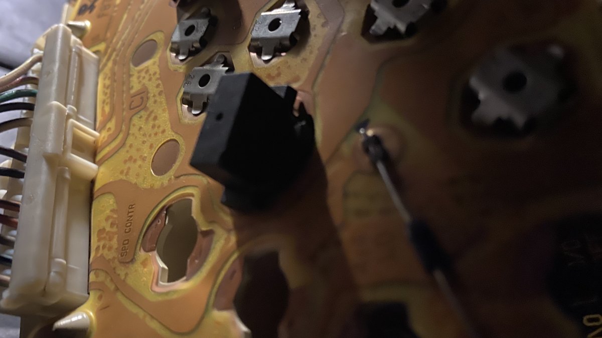

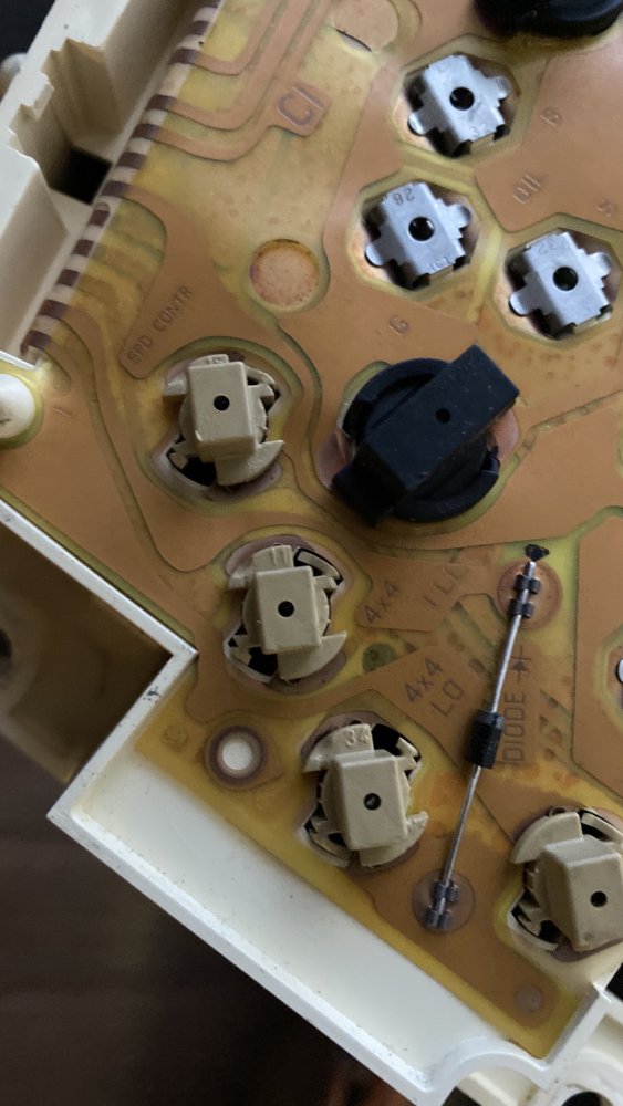

I took my dash cluster completely out and changed the bulbs. I tested them multiple times. My overdive off bulb worked, but when I changed the bulb it stopped working. I realized the pcb paper was warped a tiny bit so I taped it down and got the Overdrive off indicator to work again .

As you just stated , I have narrowed it down to the circuit between pin 14 and pin 15 of the cluster , going to the GEM , or the Grey and LT Blue wire from the switch to the GEM. Im also wondering if the bypassed brown electric clutch wire ( I use manual lockers) is acting as a ground or an indicator through amps + other wire amps
