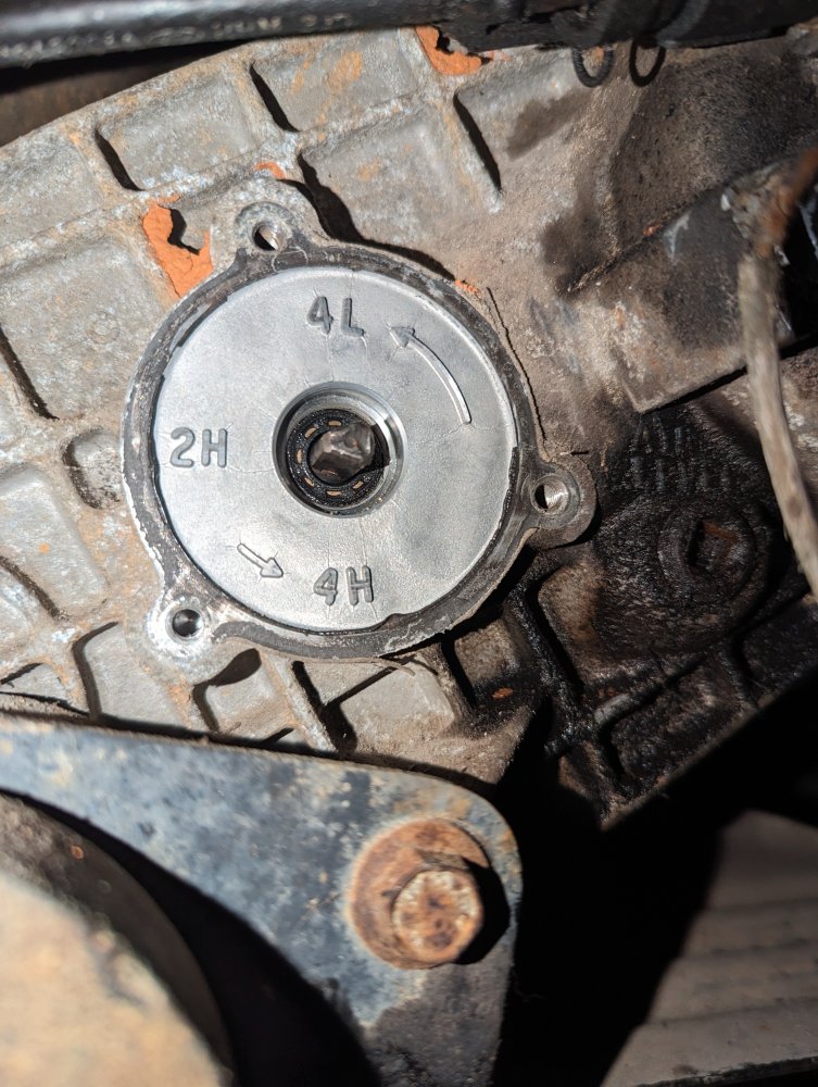

4x4 light did not come on, but I felt the front engage. So I pressed the button again and then rolled it backwards to disengage. It didn't disengage. I can feel it binding in reverse too if I turn the wheel.
Put both axles on jack stands and shift the trans to 1. Slowly let off the brakes and check, yup, both front tires are spinning.
Tried pressing the 4x4 dash button again and then put it into reverse, let it run for a count of 10, then back into 1 to see if it would disengage. Front tires still spinning.
Did some reading, tech section to the rescue!
Sounds like the tc shift motor needs some attention.
Pulled the shift motor off and it definitely looks like the tc is pointing to 2H
Is it possible the crappy auto hubs got stuck in 4x4? Or does there need to be some kind of resistance when backing up (so not on jack stands...) to disengage it?

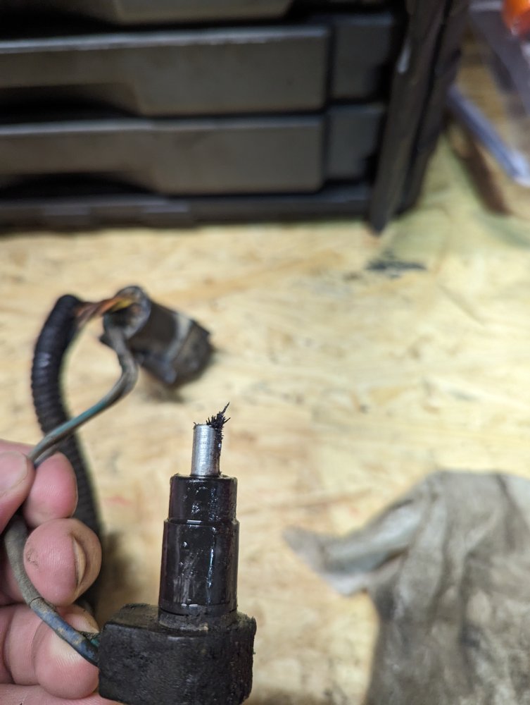

The little sensor that came out looks to have a good chunk of metal dust on it.:eek:
Going to have to get a pry bar on the tc fill plug as I couldn't get it to budge with a half inch ratchet and some choice words.
Additionally, the tech section article shows the shift motor 'cap' innards. How does it come apart? I really don't want to break it by just prying on it...

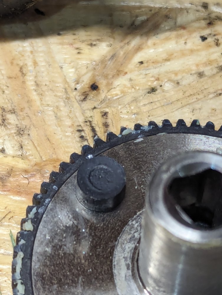

I'm guessing this truck has seen very little 4x4 usage. Upon inspection of the gear, I was expecting to find the bushing blown apart like the article shows..
It's pristine. Not smooshed or beat up at all.

the shaft pointed at 2h does not do the actual shifting. it puts pressure on a spring that in turn puts pressure on
the shifting cam that actually moves the shift forks.
the shift forks won't move until the gears line up, that's why you back up to relieve tension & align the gears.
there is a collar that slides and couples the rear output shaft with the gear/sprocket that drives the chain for the front output.
sounds like that collar is stuck.
maybe you could induce some vibration/rattling to entice that coupler to move.
try having 3 wheels on the ground & one jacked up.
grab that one and rock it back 'n forth to induce some drivetrain shocks. you may get lucky, at the very least you'll
probably scare your neighbors away.
going to 4L engages that coupler and the planetary gears for reduction.

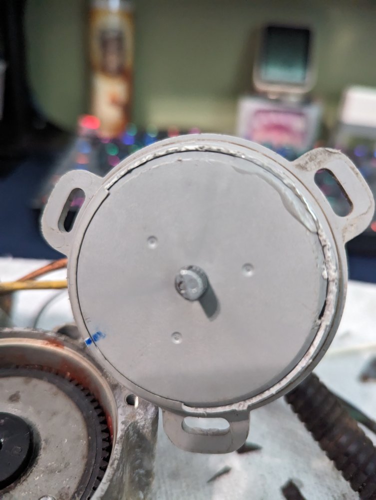

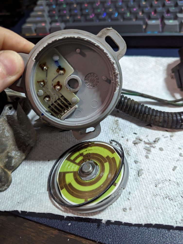

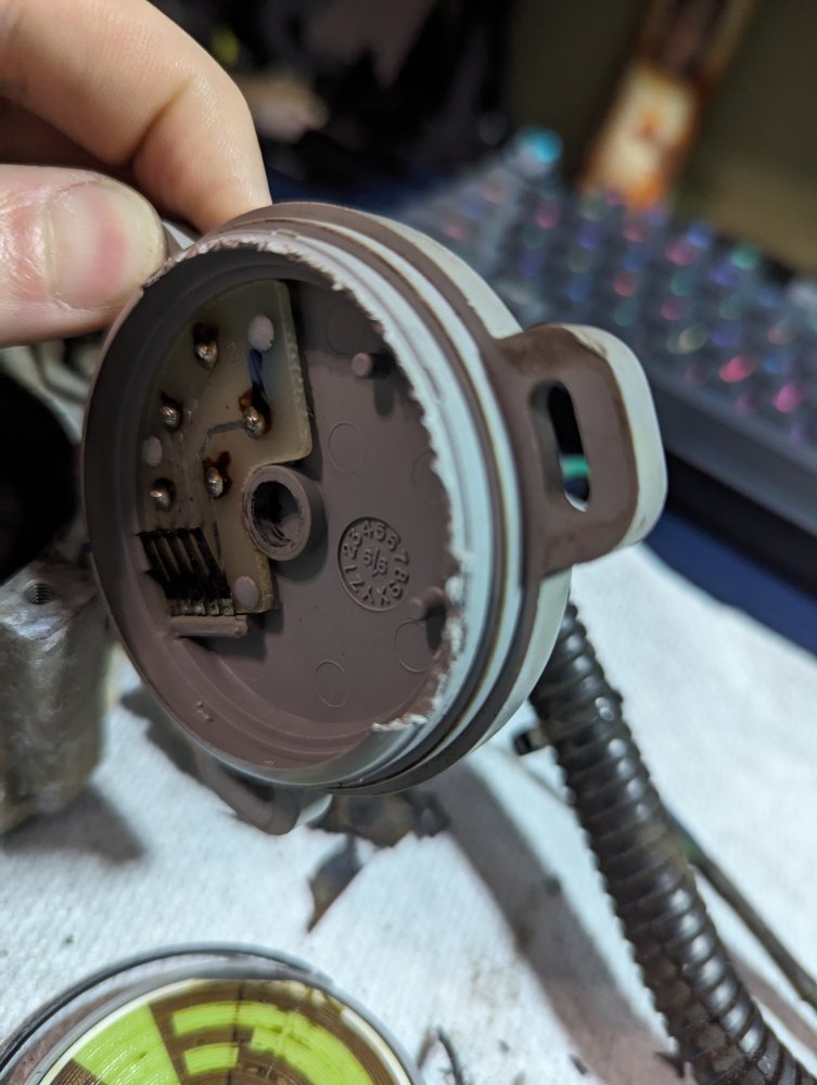

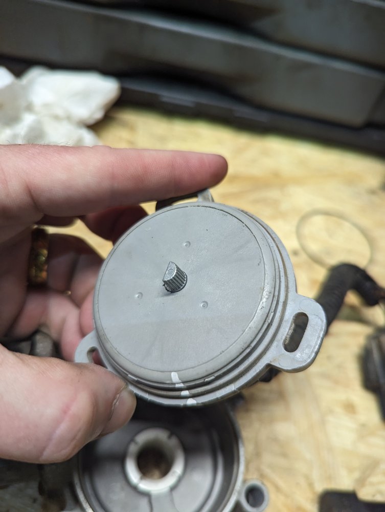

Well, found an old picture of the cap disassembled and figured out how to do so.
I imagine at some point in the last 30yrs the plastic surround that holds the interior cap in place was somewhat flexible. That's no longer the case and I ended up breaking about 2/3 of it in order to release the interior cap.
Broke the oring inside as well but don't really see the importance of it. Cleaned off some black grease from the contact pins as well as the circuit print board.
Then added just a little dielectric grease and closed it back up. Added a touch of epoxy to make sure it doesn't come apart
Probably should have tested the motor itself before spending the time on this part. But will do that and then assuming it's ok, reinstall.
