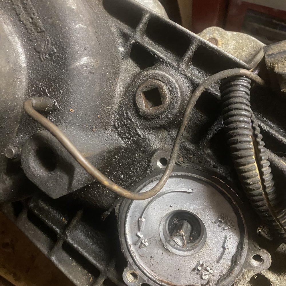

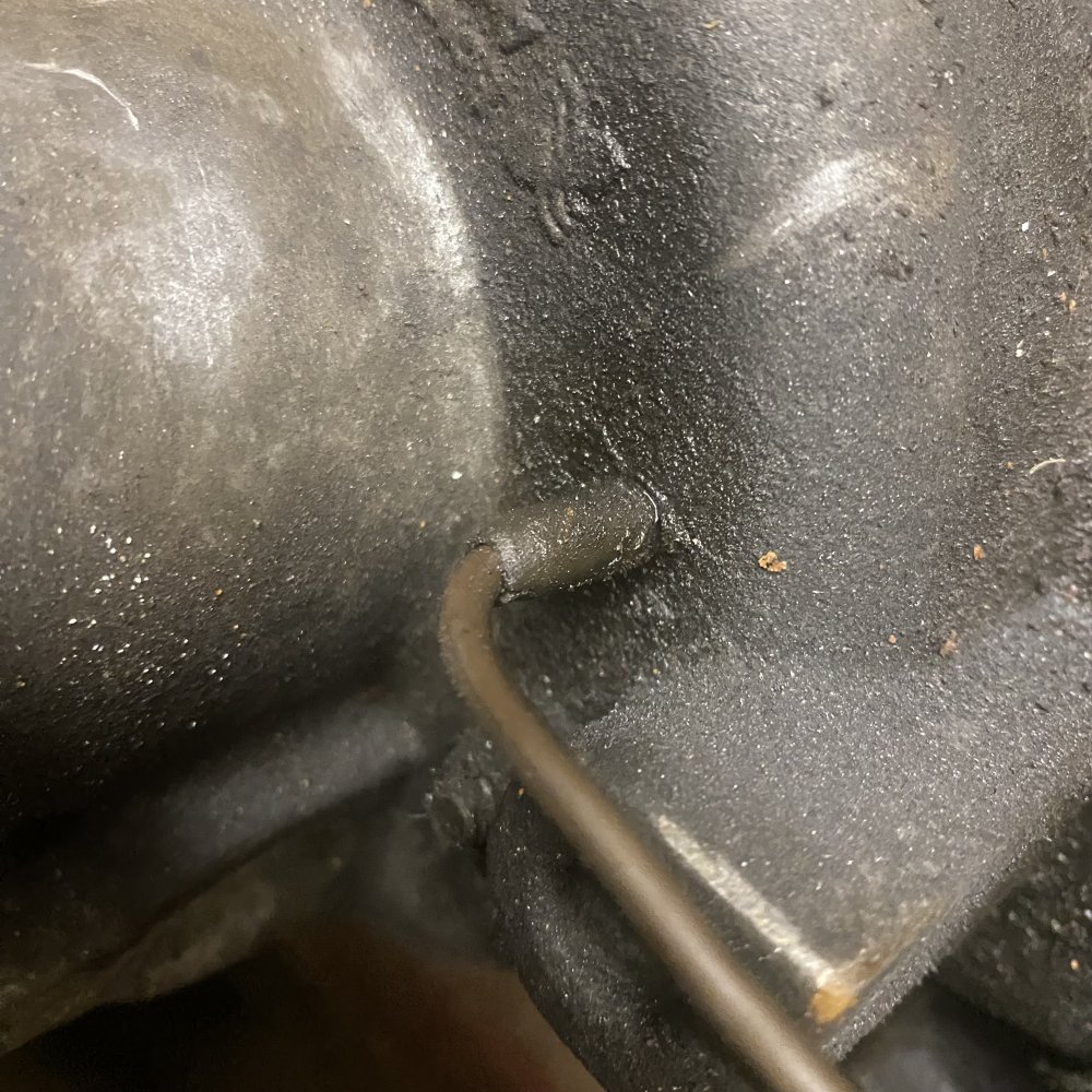

Hello Ron. I have the 8th brown wire incorporated into my tc motor plug. Every replacement tc motor I see has no brown wire. If I use one of these (7 pin) motors as a replacement should I just re pin the 8th brown wire into the plug? Pic of the ‘extra’ wire. Thank you in advance.

The brown wire is for the electric clutch inside the transfer case
It is only used on 4WD vehicles(Rangers) with Automatic front locking/unlocking hubs
If you want to keep it then just get a single wire weather proof connector and make it a separate connection from the 8 pin connector
If you have Manual Hubs you may not needed it anyway

I had the vacuum hubs but they were not working before I got the truck so I do manually lock the front hubs when snow is expected etc. like you suggested. I just cut the brown wire and connected it also as you suggested. I appreciate the response and thank you for sharing your obvious wealth of knowledge.
