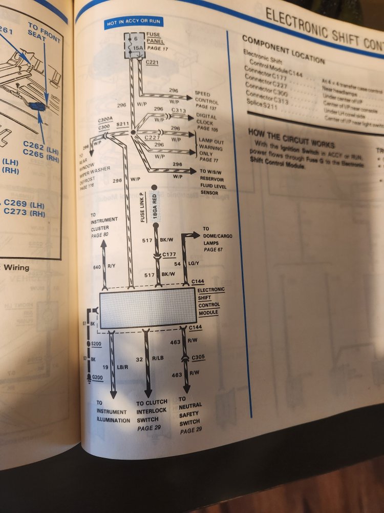

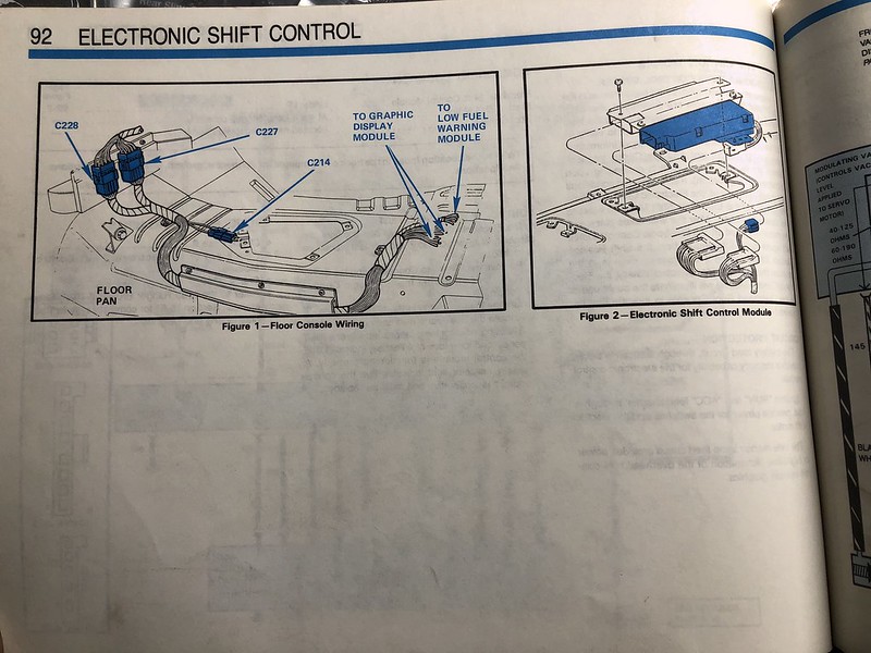

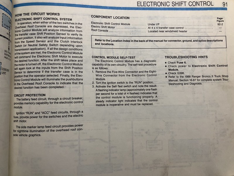

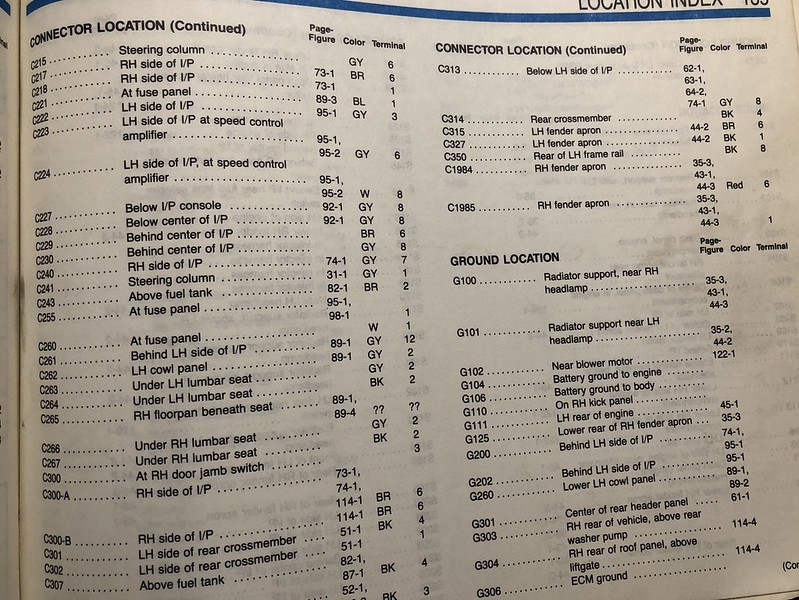

This is from the '88 EVTM, it might help.
The wire colors on the black connector you pictured don't match up with the diagram 85_Ranger posted and they don't match up with my diagrams for a 3rd gen truck. But that doesn't mean it isn't for the 4x4 system. If your wiring is similar to mine, just different colors, then, in the dash, you would have a connector at the back of the 4x4 pushbutton assembly. Then there would be another 8- pin connector in the same harness. Those wire colors should all match up.
Your other random connectors could be for options your truck doesn't have. The more "basic" or "stripped down" your truck is, the more "extra" connectors you will find. Things in that area behind the dash could be warning chime module (key in ignition, lights on, seatbelt, etc.), light for the ash tray, ABS module, windshield wiper delay module, etc. The best way to track things down is to get the EVTM (Electrical & Vacuum Troubleshooting Manual) for your exact year model of truck. These books are often available on eBay. The EVTM is where 85_ Ranger got those drawings and book pictures he posted. Having a copy for your exact truck would match up wire colors. Connector shapes and locations and most importantly, the wiring diagrams.

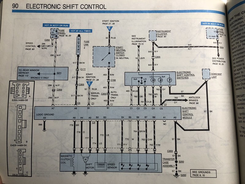

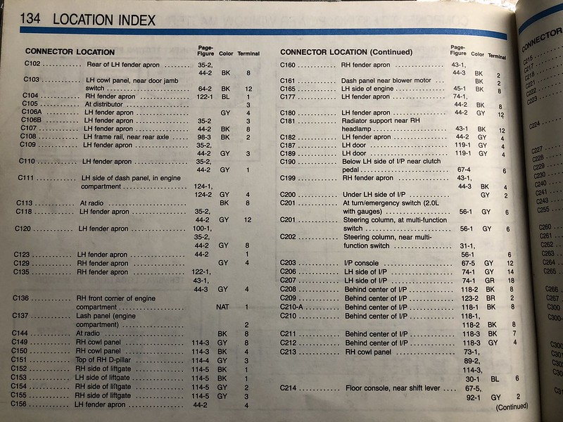

This is from my 86 EVTM...
It seems kind of off, there is nothing going to shift motor. The motor like never changed. I pulled the one out of my '86 parts truck and it was plug and play in my parent's '94 Explorer. Also nothing going to the switches.
Oh it's definitely off...
No switches... no encoder motor anywhere in my 86 book.
