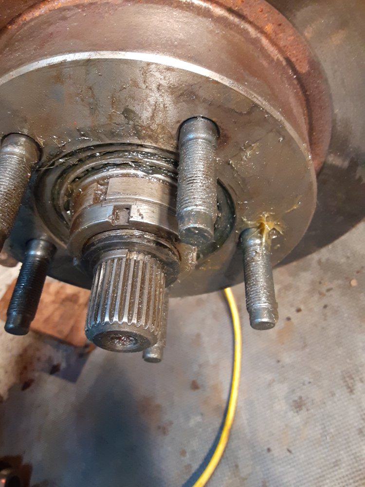

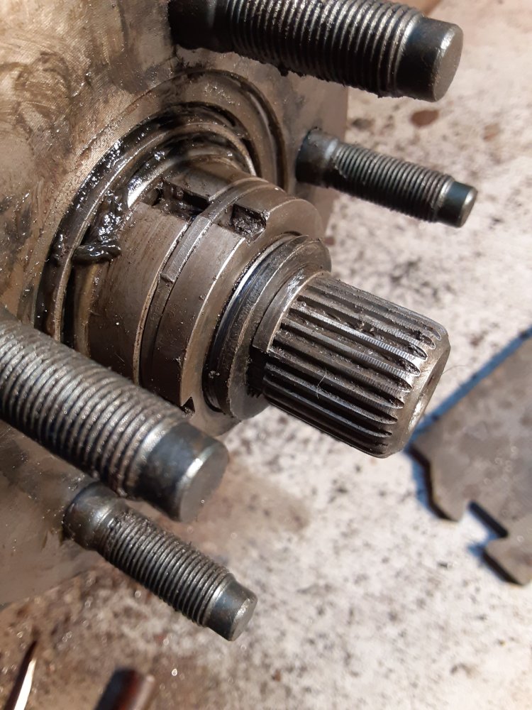

I win. Finally got it figured out and back together.
I laid out all the parts side by each and started measuring. Everything was the same except for a couple of the spacers that go on after the lock nuts. I only needed a tiny bit of space in order to fit the c-clip on the left side and had a tiny bit of extra space on the right. So I simply switched a couple of the fat ones from the left side for the skinny ones on the right and tada. it fit.
Thanks for all the suggestions and links. Mark this one as done.
