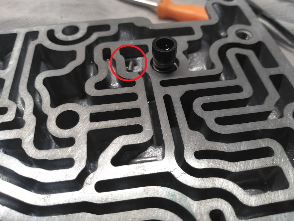

While I had the valve body out I decided to do the Superior shift kit. I found a bunch of issues, including two missing keepers on the coast clutch valve and the boost valve was stuck in its passage (wouldn't move.) I got that freed up and made new keepers to replace the missing ones... the most concerning thing I saw was that the converter relief valve & spring is just not there (the EPC relief valve & spring were present, though.)

1) are the missing keepers a problem? Were they not present on early transmissions? Or did the shop just leave them out?

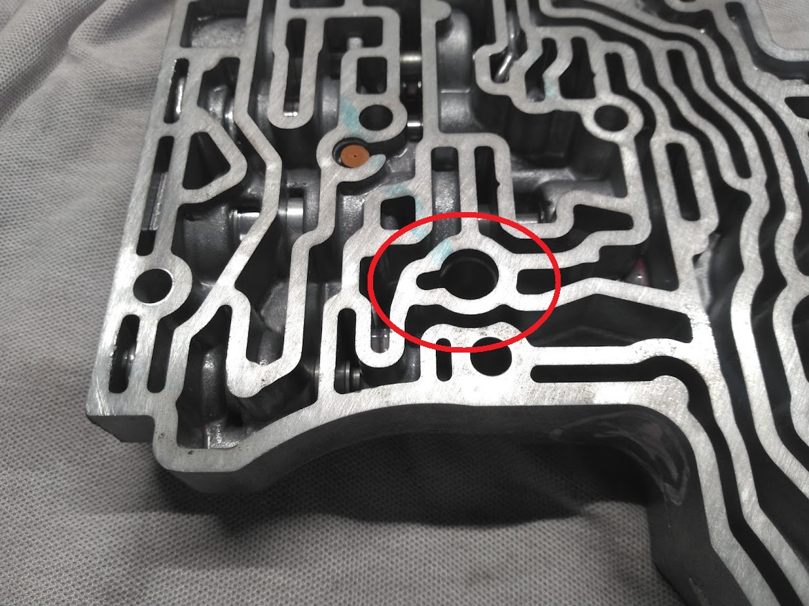

2) Is the missing TCC relief valve & spring a problem? There is no hole in the separator plate for it (there is a hole for the EPC relief.) I found some diagrams online that showed my situation as normal, and other diagrams that showed both valves present. So which is correct?
Hole where TCC relief valve "could" go:
This is one of the keepers that was missing and where the EPC relief was at.

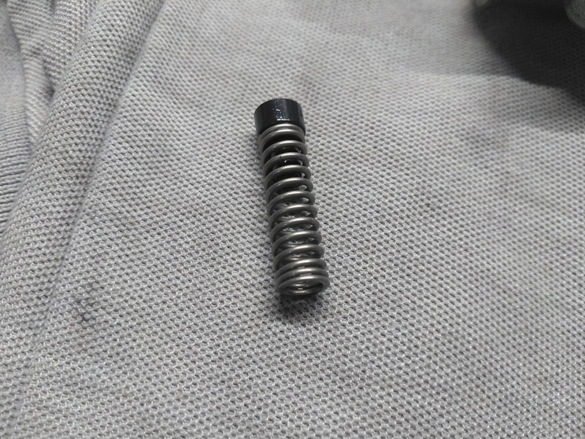

This is the EPC relief valve I have, it has a plastic tip

Well I found the damn keepers - the two missing ones were in the pan of oil that I drained out. I KNOW they were in the pan, because I drained the fluid and removed the drain pan before I removed the pan from the transmission, so they came out with the oil... did not fall out when I removed the valve body. There was no way for that to happen anyway since they're between the separator plate and the valve body. How they migrated out and into the pan is a total mystery, but they're back where they belong now.
To recap - still not sure how the keepers made their way out and into the pan but the trans seems functional without the converter relief valve & spring - if they were even in there to begin with.
