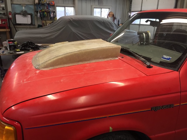

I trimmed the cowl induction hood scoop that I made today. I will leave it in the raw for a couple of weeks to let the fiberglass cure before I finish the scoop and make it smooth and nice to look at it. I was amazed at the amount of material that I removed in order for it to fit. When the hood is raised the scoop barely clears the windshield and the wipers. You would think there would be a lot of room when you look at the photo.

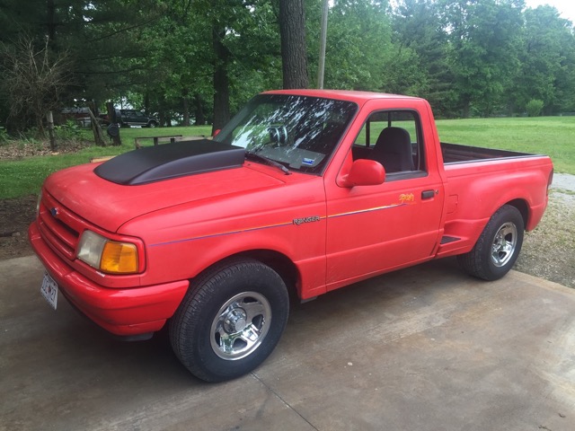

I have completed the rough shape of the functional cowl induction hood. I am going to step away from this project for a while and do some other stuff. When I get back to this I will smooth out the hood scoop and paint it flat black. View attachment 38925

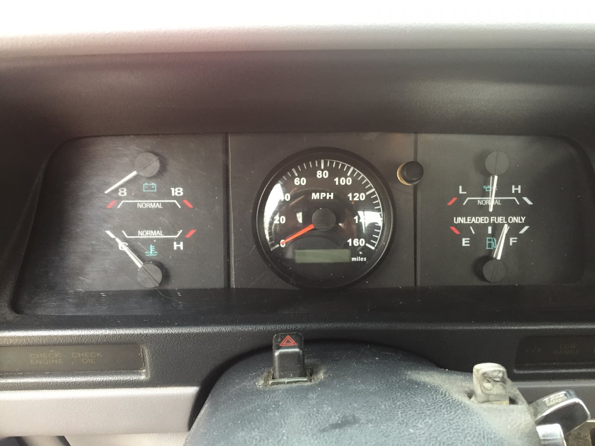

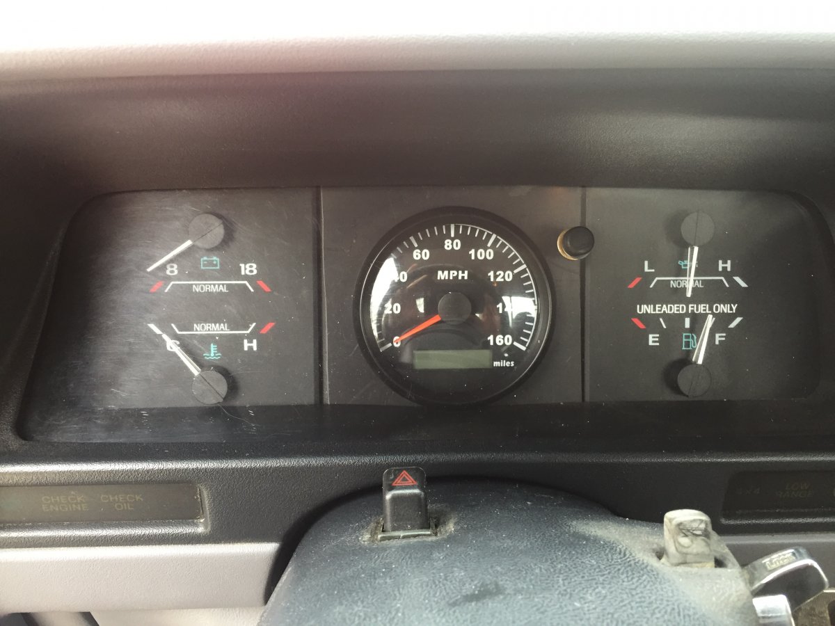

I replaced the original speedometer with a gps unit. It was difficult to modify the cluster but it just barely works in the space. It is a 160 mph speedometer which is kind of a joke. This will automatically adjust for the different sizes of tires, or a different ratio rear axle, should I change things around later.

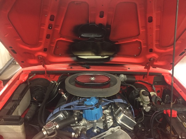

I have finished the hood scoop that I made from scratch and the rest of the parts for the cowl induction. I plan to take it to the drag strip soon.

I just ran on to this post that I made last year and I thought I would update it some. All the events that I thought I might enter were canceled last year and although I did some test and tune at the drag strip, most of the time I just drove the truck as a daily driver. This year I was invited to enter Hot Rod Drag Week but I have decided to try for Rocky Mountain Race Week 2.0 instead. That will take place in September. I will be in an index class for that event.
The truck launches straight with no wheel hop. I feel a little wheel slip when I take off and my zero to 60 times are not what I would like but I will continue to work on that.
The truck has performed well during the last year with only minor changes. It is a lot of fun.
Speedhut speedo gauge?
