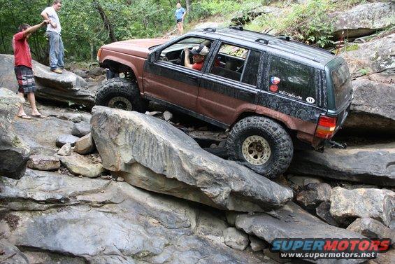

I dont think 35" is where you need to step into 1-tons, maybe reevaluate your driving skills/style. This is my buddy Jason's jeep on built 44/9" with 38.5 SX's, and a V8
They do pretty good, but I will say 38" tire range is where you need to start seriously considering D60's.
