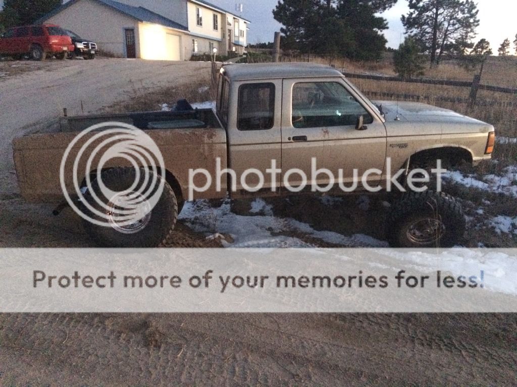

5.13s I love mine. I should have gone lower. I am on 35s with a 44 and an 8.8. It could be lower in the rocks and pulls great on the hwy.
How about in mud?
I don't do mud unless I am forced to. It does great in the snow. I was hunting all week in knee deep snow and 4 chains. Sometimes 4 low first gear sometimes second.
I have 4.88s and love them but would like 5.13s more in the dirt I drive my truck on the highway a lot though
It was a little muddy when I got home.
