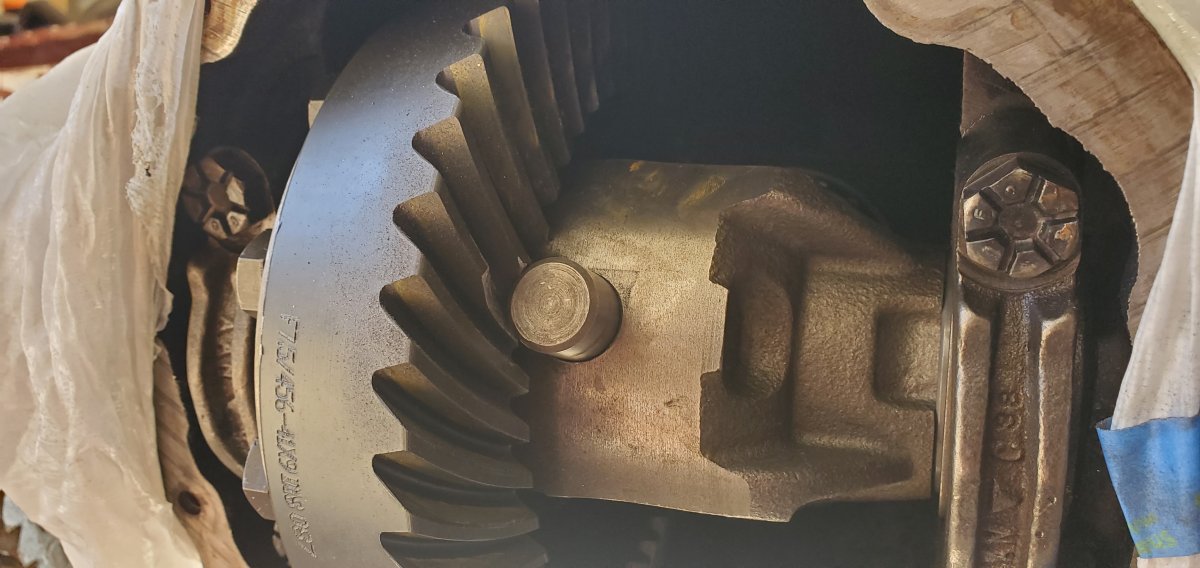

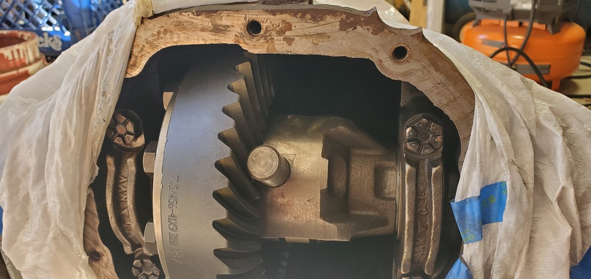

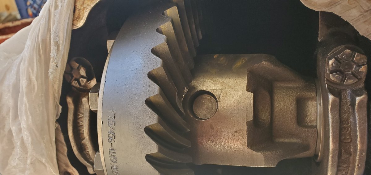

I got pics from when I did mine. Hold on a sec
71088
71089
71087
I used a demel and it worked fine. Pic the side thats going to need the least amount of removal, then slowly start grinding the teeth down. Keep checking to see if you can slide the pin out every now and then. Keep doing this until it just slides out. Clean up and make sure everything is smooth and free of shavings. I have 1000+ miles on this gear and no issues at all.
