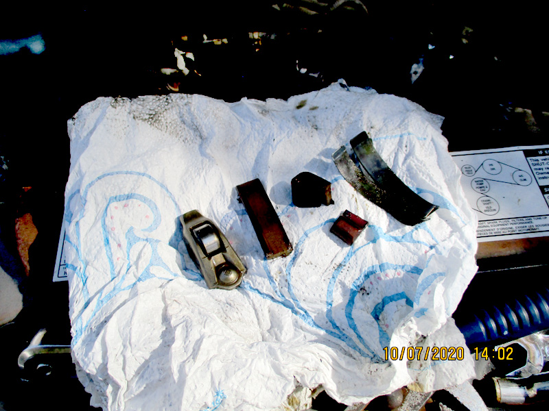

My Brother in law and I did some work on his '01 Exploder Sport today, I never seen valves bent so bad you could just lift out the rocker arms (a couple of them anyway) seems the front lower timing chain guide came apart and allowed the jackshaft to jump out of time.... ugh..
