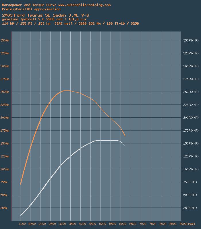

In fact both these engines have a 5200rpm hp peak (at least my 2004 3.0 does). It's hard to tell how flat the power curve is without a plot, but the 3.0 is not a peaky engine. The 4.0 is making 136hp at its torque peak of 3000rpm. The 3.0 is making 134hp at its torque peak of 3900rpm. The only plot I found was for a 2005 Taurus 3.0 which had a very flat torque curve between 3000-4000rpm, but that's a different cam and manifolds.

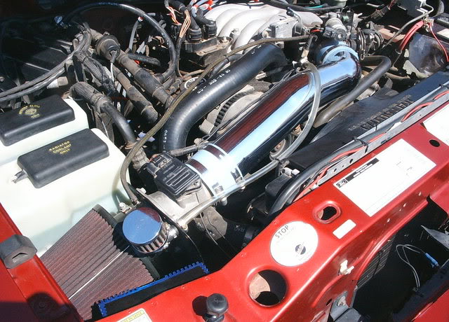

I just like, in both my Lightning and Ranger, when driving around town with the OD off, when you put your foot in it, you don't have to wait for that delay before the trans shifts out of OD. It's already out of OD, and wham you're gone. Plus, my intake probably exacerbates the already rev happy motor. The crimped down stock tube helps keep intake velocity high during slow movement. When you put a full three inch tube on there, it slows the airflow down. Keeping it out of OD helps keep the intake flow high. But, when the rpm's are up, it sure sings a nice tune. Even without a muffler, the intake noise is louder when the petal is down.
I tried putting the stock intake tube on with the cone filter. Don't like it at all. Totally kills the power it makes with that big tube. It's an old MAC intake. Can't get them any more.
I'll have to take another picture, it's not the same exactly. Different sleeves, different filter. Spectre stainless steel mesh filter. Way less restriction than any other filter out there. Way louder as well.
