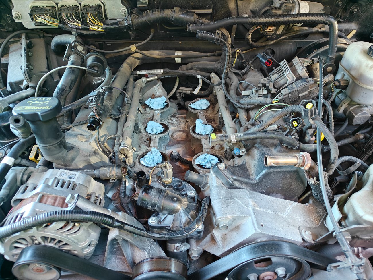

If you can leave the AC and power steering stuff intact, do it, I know I can on OHV engines but it's a real pain to get past the AC lines. Yours looks easier in that regard, they don't go up and over the engine.

Shran, I did take the power steering off but was able to unbolt the AC compressor from the power steering bracket and that's sitting nearly off to the side out of the way. Glad I could leave the AC alone as it does blow ice cold already.
