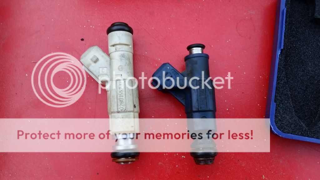

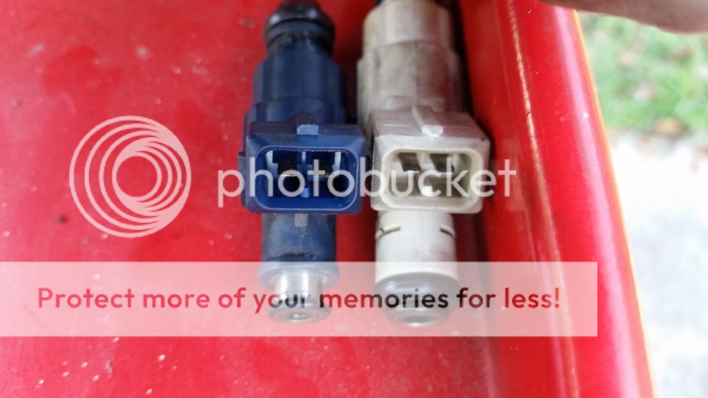

Comparison:
The blue injector is a stock SOHC, the white is a Bosch 36lb injector. Notice the different lengths in the bodies and the shape of the plastic tips around the nozzles. The new one has a flat disc, while the old ones have a tapered design to them. Some people have reported the discs breaking as they put them in the injector seals, but I had no issues during test fit or final mock up.

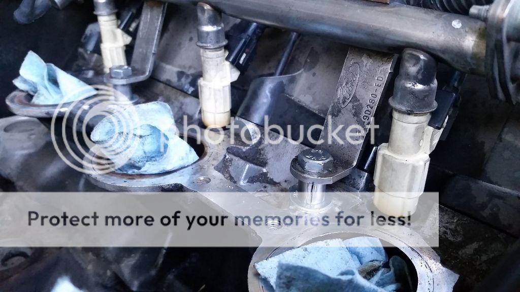

Fitment:
As picture below, the fuel rail mounts directly to the head with 4 M8 1.25 pitch bolts (2 each side). Luckily, these mounts are parallel to the injectors, so a simple 1/2" spacer and a longer bolt will allow the fuel rail to properly mate with the new injectors. I put a washer between the spacer and the head because I don't like the idea of that much pressure and vibration being transferred through such a small surface area. If you're worried if the injectors are seated correctly, you should be able to twist them in their seats with minimal effort. If there's binding, check that you didn't mess up an o-ring.

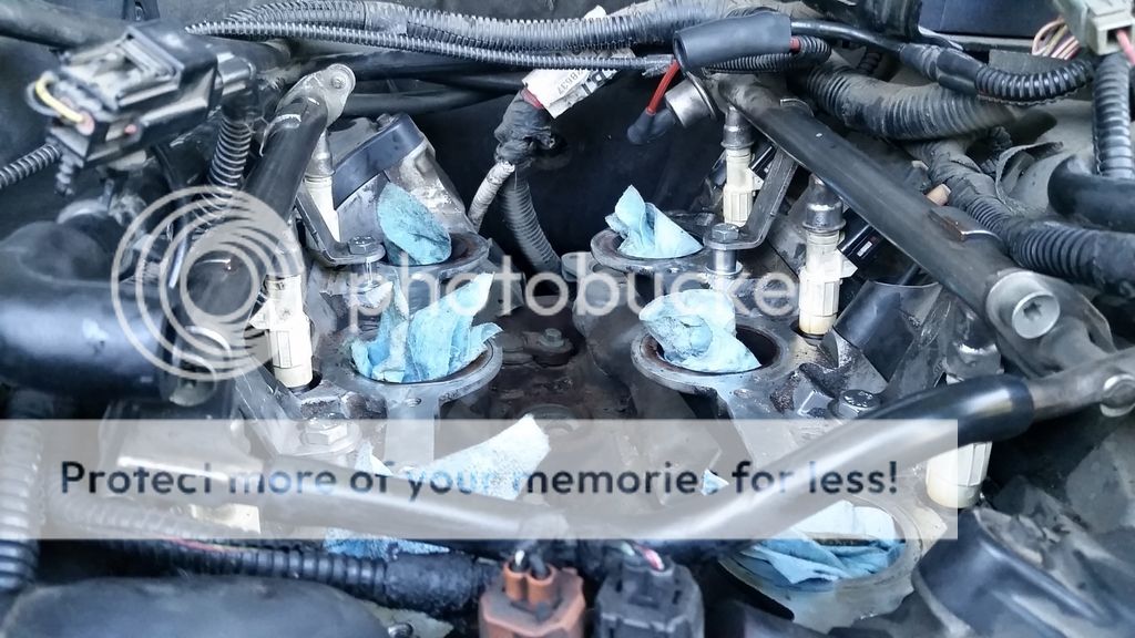

Clearance:
I was worried that the fuel rail would be too high up for the intake manifold to sit back down properly (Speaking of which, now would be a good time to replace those gaskets). The fuel rail actually clears everything with about a 1/4" all around, with the exception of the vacuum port behind the throttle body on the passenger side. I have light contact on the larger rubber elbow, but as my old shop boss used to say, "Rubbin aint touchin." I'll report back if that appears to have any issues.
