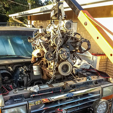

Well I heard back from the machine shop and they are not going to do any sort of warranty for me. They said there is some sort of service bulletin about using later heads with an eatlier Computerand causing a lean condition . However, I don’t think that is exactly what the tsb says. And they didn’t realize that the intake valves are garbage too which isn’t a lean issue.
does anyone know what tsb they are referring to?

the fast burn heads are later and can really be a problem with the early pcms. bank fire or sefi, but bank fire is generally pretty forgiving...
this is why i always suggest keeping known running systems intact on a 4.0. and do not like rebuilding them with cracked heads when i have to find parts...
there are all sorts of changes all through the life cycle. there is a cam biased towards manual and one auto....this combo depending on which piston is in there can lean it out to the point of destruction....
my son melted an engine pretty quickly in the bronco....had i been there to hear what it was doing we would have switched the pcms.....it was an oversight and he finished up putting it together....of course i was not panning on him to do that and beating the fawk out of it out back before i got back to town...

...not sure what happened from the pics but i sure as hell would like for you to get the heads back and disassemble them yourself and give ss the dimensions of the valves and compare those to stock.
how that engine ran at all is a wonder.
double check the timing gear is correct and not slipped as well.

I am actually seeing three piston variants on RockAuto - 90-94 small dish, 95-00 big dish, and 98-00 slight recess, almost a flat top.
I'm not really sure what to suggest. You could find a different machine shop and have them go through your heads again and hope they use better valve seats (I still think they used cheap parts thus the failure) but that is a tough call, nobody here will know what brand of seats are good and which ones are not, I kind of doubt that most machine shops would know either.
You could put older big chamber heads on it but you lose compression ratio that way with your pistons. Not great
You could use older (90TM or 93TM) heads and older small dish pistons in it, basically back to stock - wondering if this might be the way to go with your ECM, you will have money into heads no matter what route you go
If you fixed what you have now, you could try running a later 93 or 94 ECM or do an OBD2 conversion on it and run '95+ stuff. Late OBD-1 ECM seems like somewhat of a gamble. OBD-2 conversion brings a lot of other things into the mix (cam sensor, EGR, etc.)
But maybe this just happened with shit valve seats and good ones will get you up & running indefinitely.

Hmm I would like to see the TSB that the machine shop is referring to. I don't think it is a case of computer/ head compatibility. I think it is head and block compatibility. But I could be wrong.
I am leaning toward running these heads again but with a machine shop working on them that doesn't suck. The guy said they used GSI valve seats or something and that if they were a problem they would have had others that were a problem. However, who runs an old truck like this to 30k miles in 2 years? Most people are selling an old truck before 30k, and definitely in 2 years. And it is not like they would tell me if someone else had an issue anyway.
The only two things I can really imagine:
1. They used crap material like someone said. Not hardened or something. Cheap china garbage. They wore out. Perhaps the other stuff they have done has had the same problem- but I am the only guy to actually figure it out?
2. The heads I got had hardened valves for propane. Like these were NOS heads, but for a propane application. The valves were hardened for that, and the seats in the 93tm were hardened too- which would typically be fine. However, the valves were moved to a 95tm head and regular seats were wore out by the hardened valves. I don't think this is a thing because I haven't heard of hardened valves for propane, only seats.
