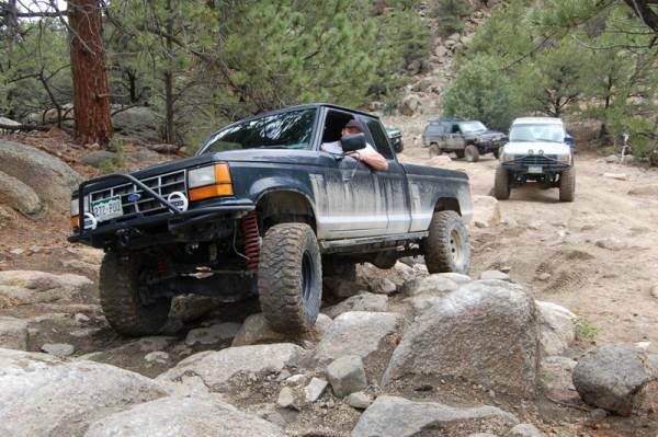

I'm on my phone or I would post a pic, but I had SJ 6" coils and 35s. It rubbed a little at full flex with no trimming. My avatar is a good example.

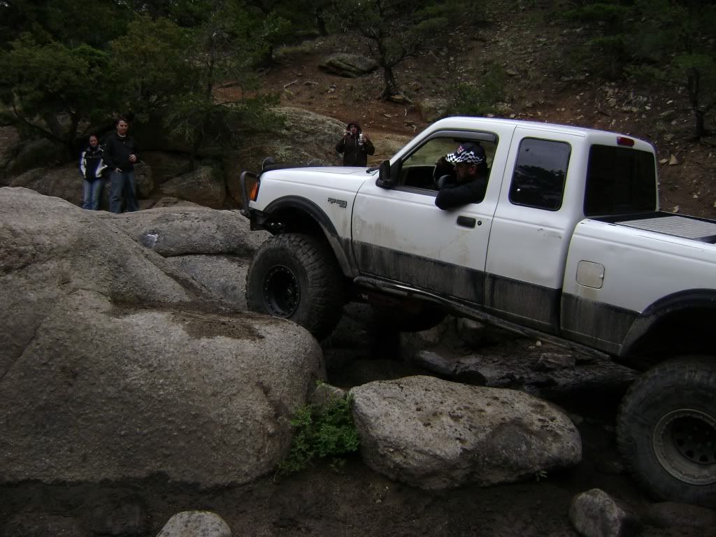

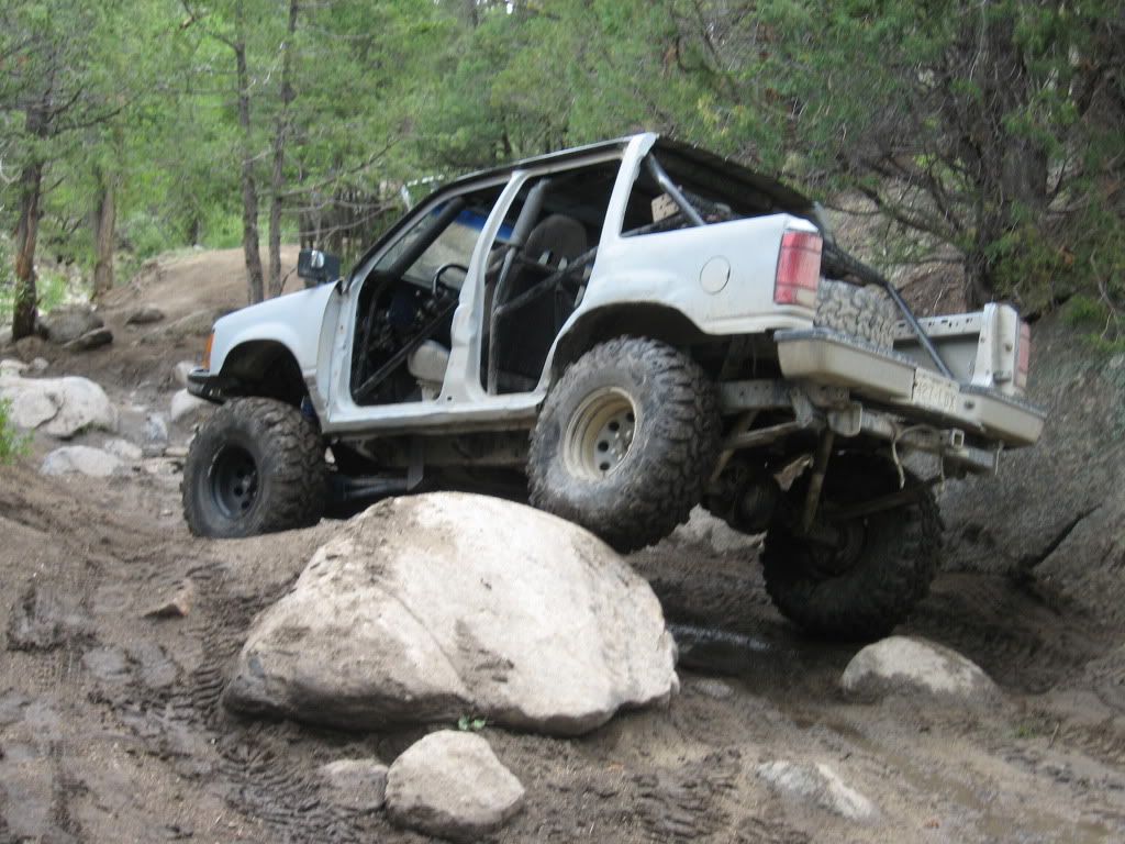

Here is my truck on 33s the Ex on 37's and another white ranger on 37s....I know the Ex has a body lift but just cut more fender and you will be fine.
