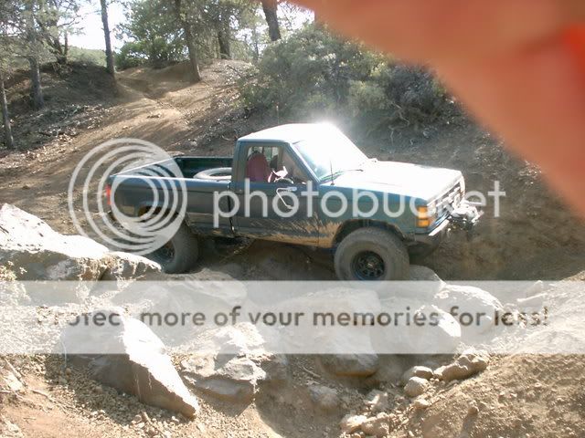

the old richer racing truck from back in the day.Good general info on the build.
