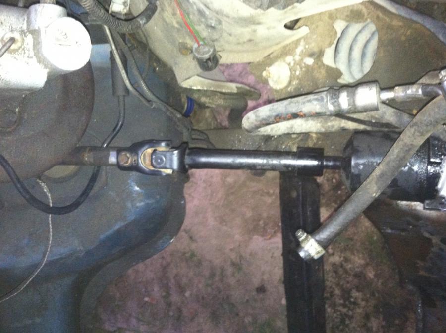

Add 3 in body lift and the most modification ive had to do is bend the seam flat in the trans tunnel right at firewall and notch heater box. I had to nock in my firewall in one spot for motor to sit back farther. And i cut out the exhaust shield for now. Im running 33s with 4 in bds suspension lift with my 3 in body. Ul have to extend steering shaft and gas fill line. And emergency brake. I pulled steering line off 90 model explorer. It u joint on top and rag joint on bottom. With slip style yoke built in.
I did see bronco 11 with same setup so u may have slip yoke style. If u do itl allow u to do body lift
